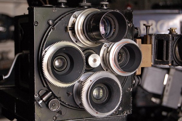

Thanks again Ed. All very useful information. The Patent plate on my Mitchell no 146 has a last entry as May 11th 1926. Patent Nos. 1,637529 (focussing viewfinder) and another 1,648559. The ENTIRE front of my Mitchell is fake. Turret, lenses, matte box and rods, all constructed, not by myself but an expert model maker. Close up it wouldn't fool an expert, but I hope it all looks plausible.

Here is a picture of my 'completed' Standard Mitchell #146 with a turret full of Bausch & Lomb lenses. 25 35 40 and 75mm. Very many thanks for all the advice (especially from Mediaed) and those who helped me assemble this beautiful object (first seeing the light of day in 1928 at RKO studios). One day I might get the rackover to unjam, but that can wait until I find in the UK a Mitchell ex-camera engineer! One day I hope my camera will be used in a movie or tv drama ( as a prop) so that the whole world can enjoy.
