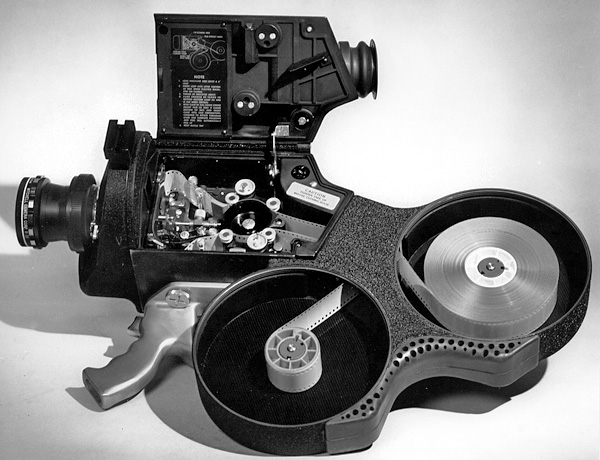

mark II blimp 5.jpg (94.49 KiB) Viewed 193736 times
This layout photo from the Swedish Film Institute shows the features that make this possible with the R-35 - the pistol grip, the revised vertical stepped magazine that also acts as a shoulder rest, thumb lug, and the (not shown here) lens turret arrangement - all geared to this end.
The hand-held aspect of the design is taken so far that for tripod mounting, it is pointed out with an asterisk, an accessory adapter is required. Of course, because it's meant to be a hand-held camera.

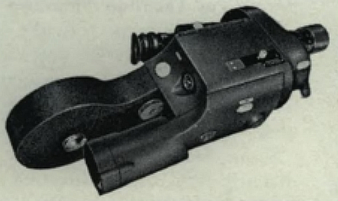

These are poor-quality blow-ups from these ads which likely are the pre-production prototypes.
It looks like the main body casting may not be fully resolved yet, but the dog-leg motor casting and other features looks the same, Not sure how the normal mags will interface on the top, but hey - this is a hand-held camera, so who cares!

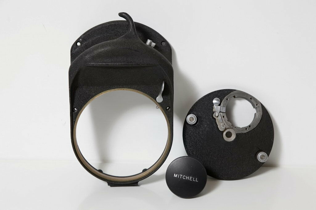

The tripod adapter can be seen here.

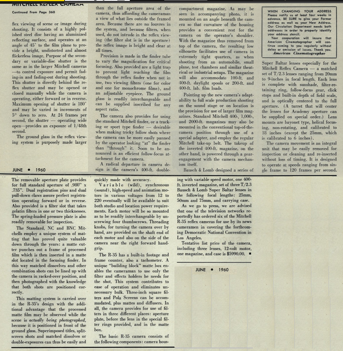

Here is a launch article about the new R-35 from the ASC mag:
