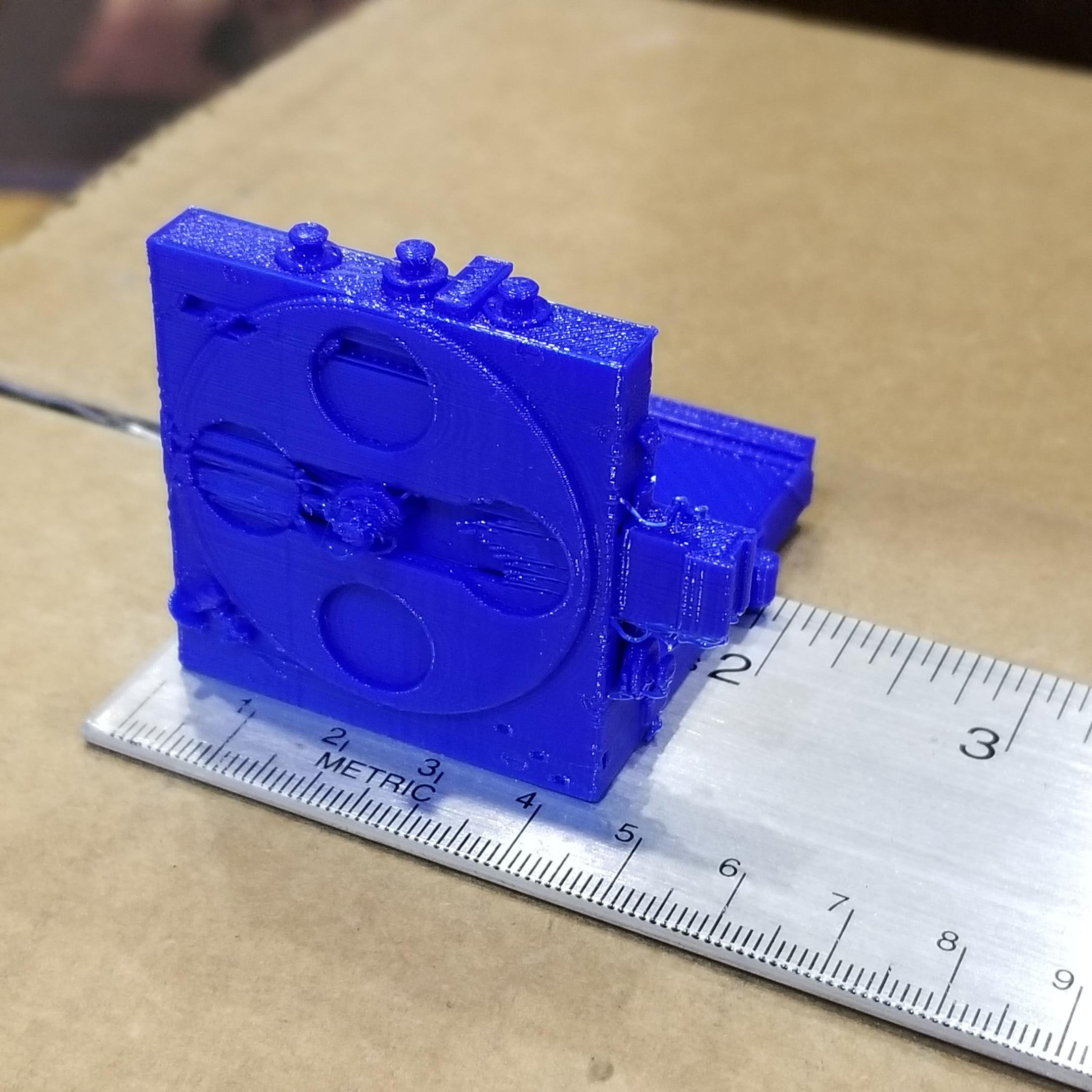

Post by admin » Wed Feb 06, 2019 2:52 pm

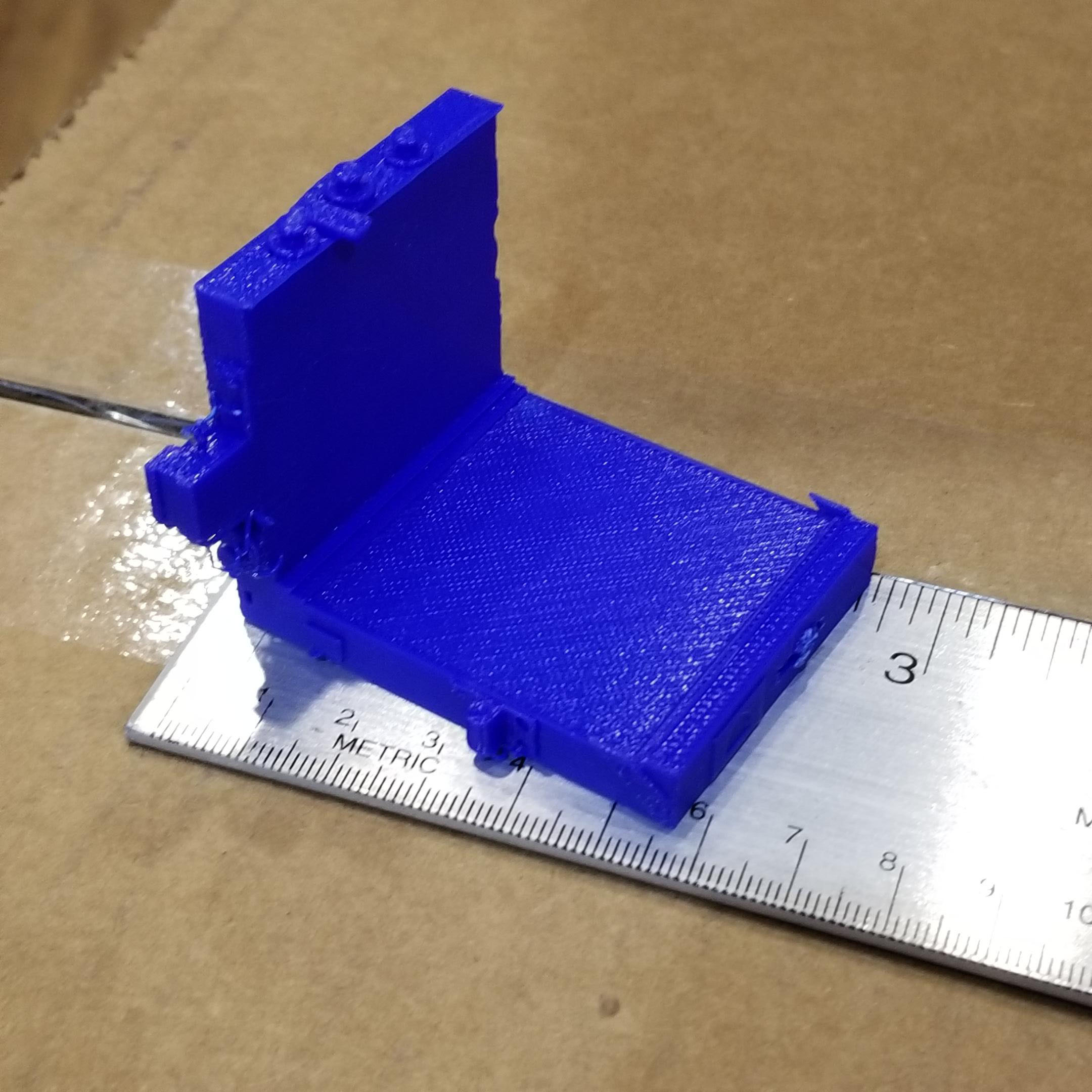

One of our members has shared early attempts at a 3D printed model of a Mitchell Standard. Thank you Mark! He writes:
Here is the first try. I just used blue because that’s what I had in the printer. Some problems arose. Mainly the issue is overhangs like the rackover handle, viewfinder mount but also the turret and turret securing knob. I’m not sure what happened there. So I’m thinking to have these removed to print separately. Also I may have to get a smaller print head to get finer detail or perhaps have a service use a different style 3D printer and then I would made a mold and use resin to cast pieces. One option is for me to use ABS filament. If I do that I can expose it to a chemical which smooths out the surface. Or I could just use the printouts as a base model that I finish by hand and made a mold and cast release models. Also this is a bit small. Again it is quarter scale.
We will be devoting and entire article page to this historic first, the world's first accurate 3D printed Mitchell Standard Model.
click to Enlarge
Click to Enlarge

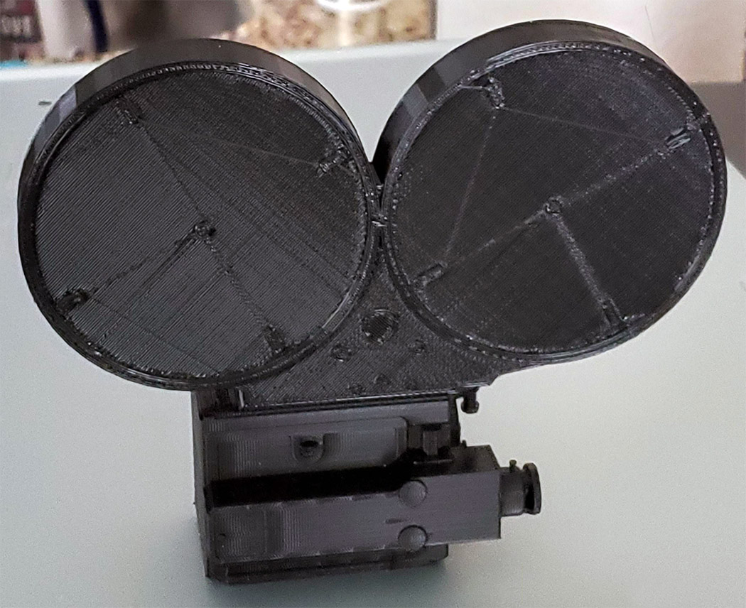

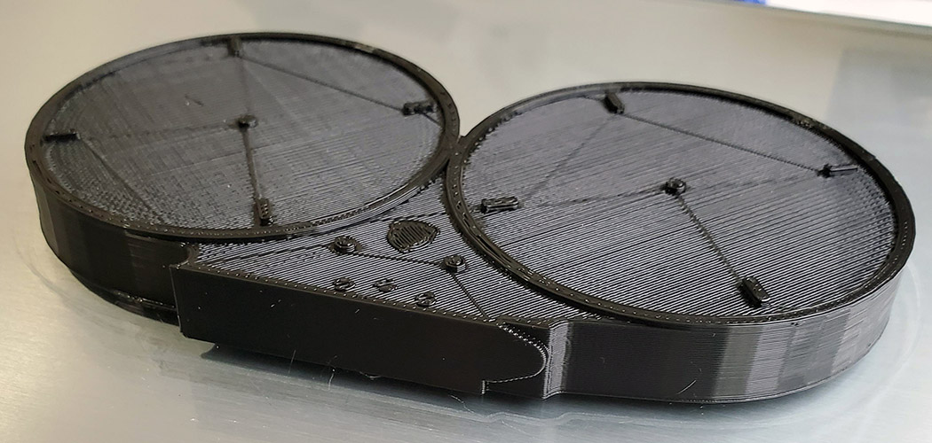

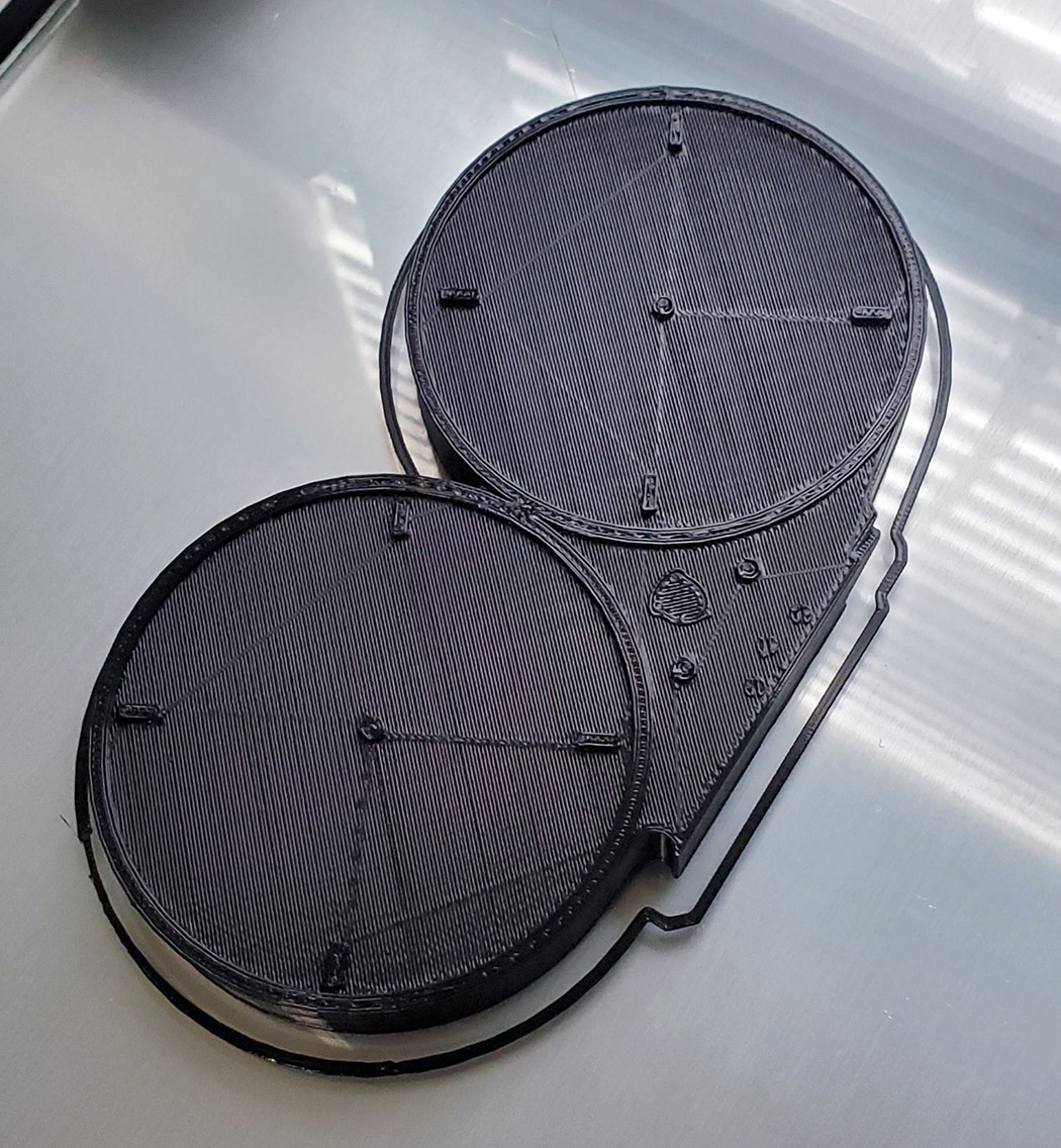

Mark has sent me more updates of his 3D print project. These are still test prints with more refinement planned.
Click to Enlarge
Click to Enlarge
Click to Enlarge

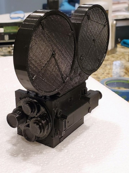

Mark continues to improve his 3D printing attempts. In the photo below, you can see the obvious improvements. Great work, Mark!
Click to Enlarge
Click to Enlarge

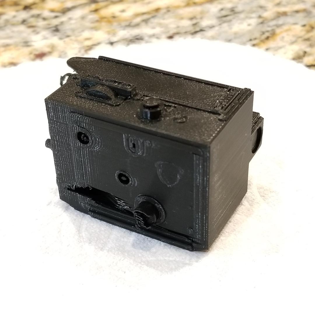

Re: 3D Printed Model of Mitchell Standard
Post by admin » Tue Apr 16, 2019 7:45 am

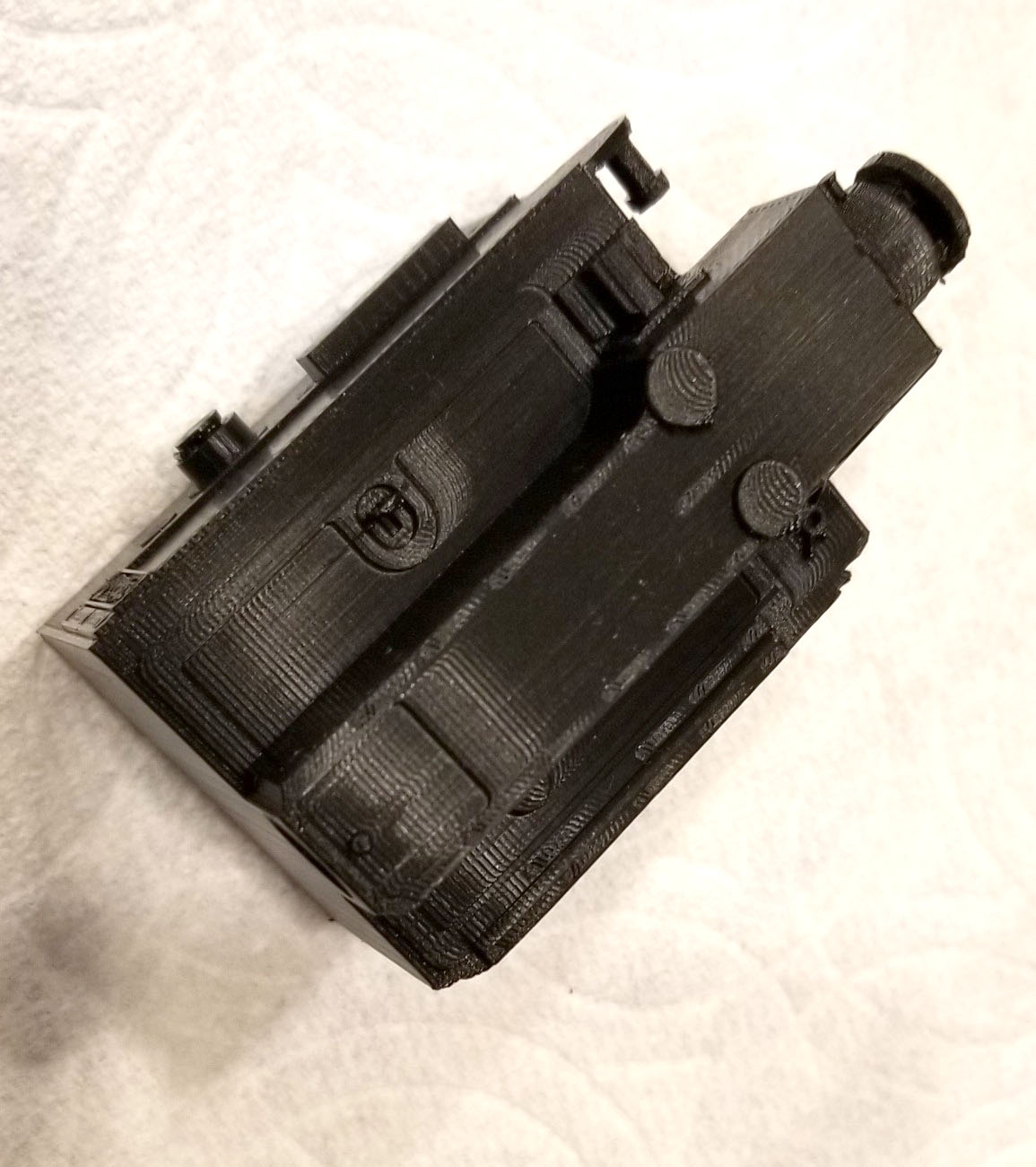

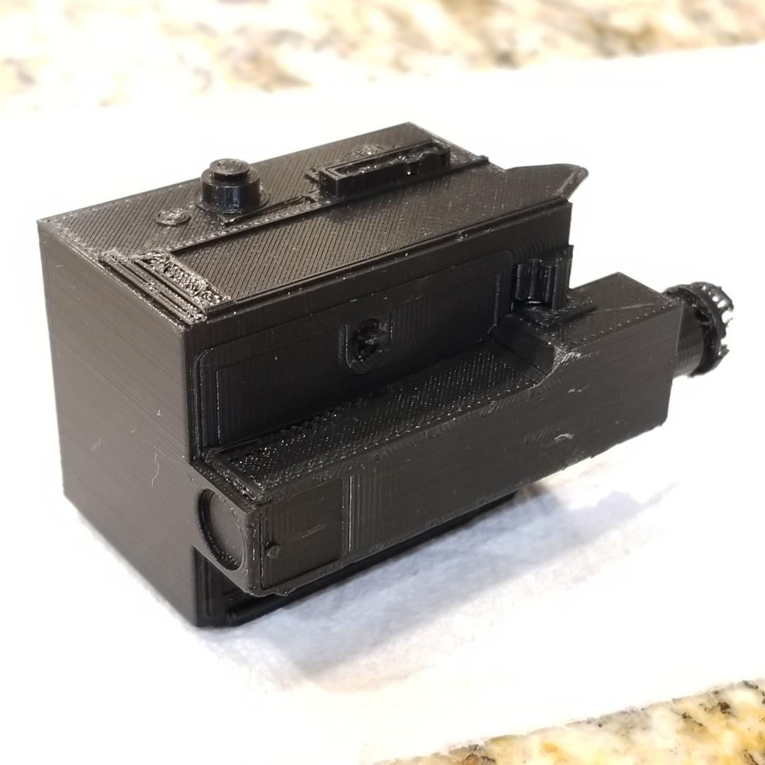

Mark has sent more progress shots, this time of the magazine.
Click to Enlarge
Click to Enlarge
Click to Enlarge
Click to Enlarge

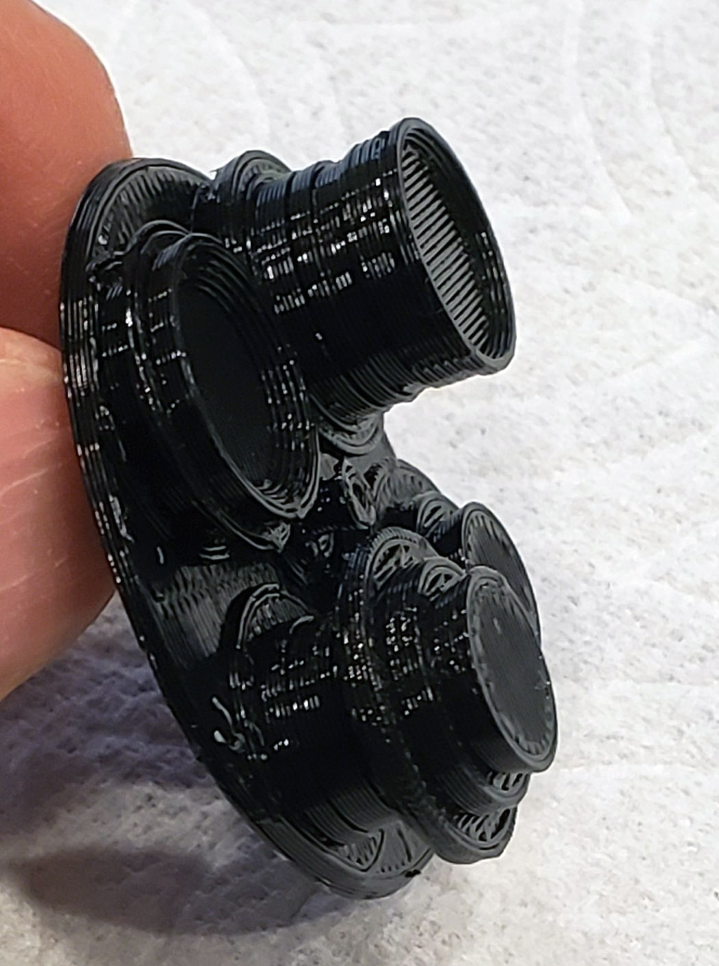

Post by admin » Tue Apr 16, 2019 7:51 am

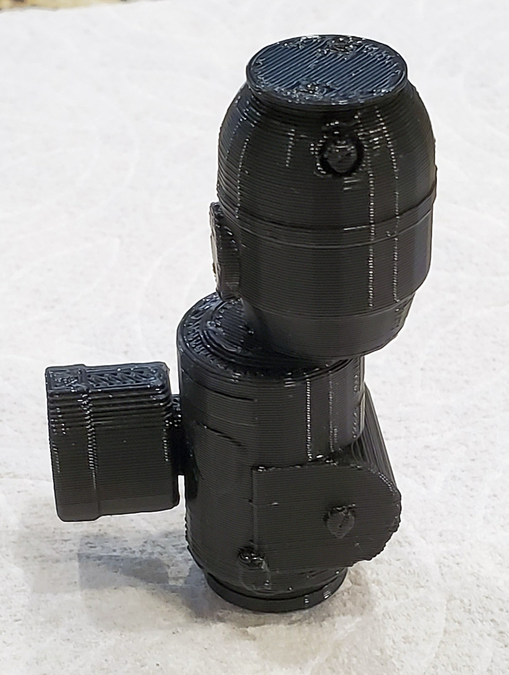

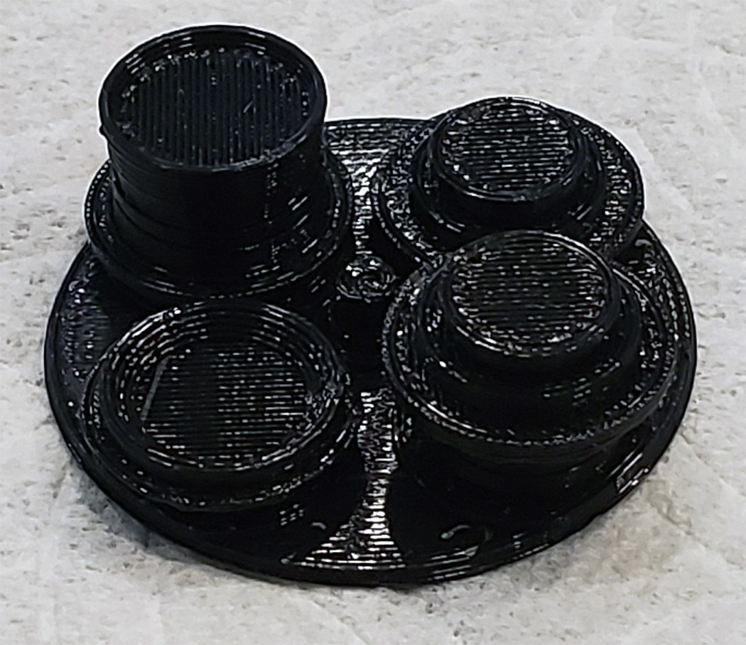

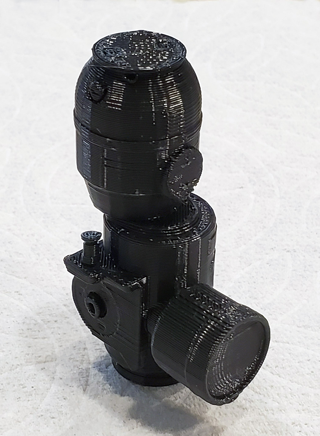

Motor and Turret updates.
Click to Enlarge
Click to Enlarge
Click to Enlarge
Click to Enlarge

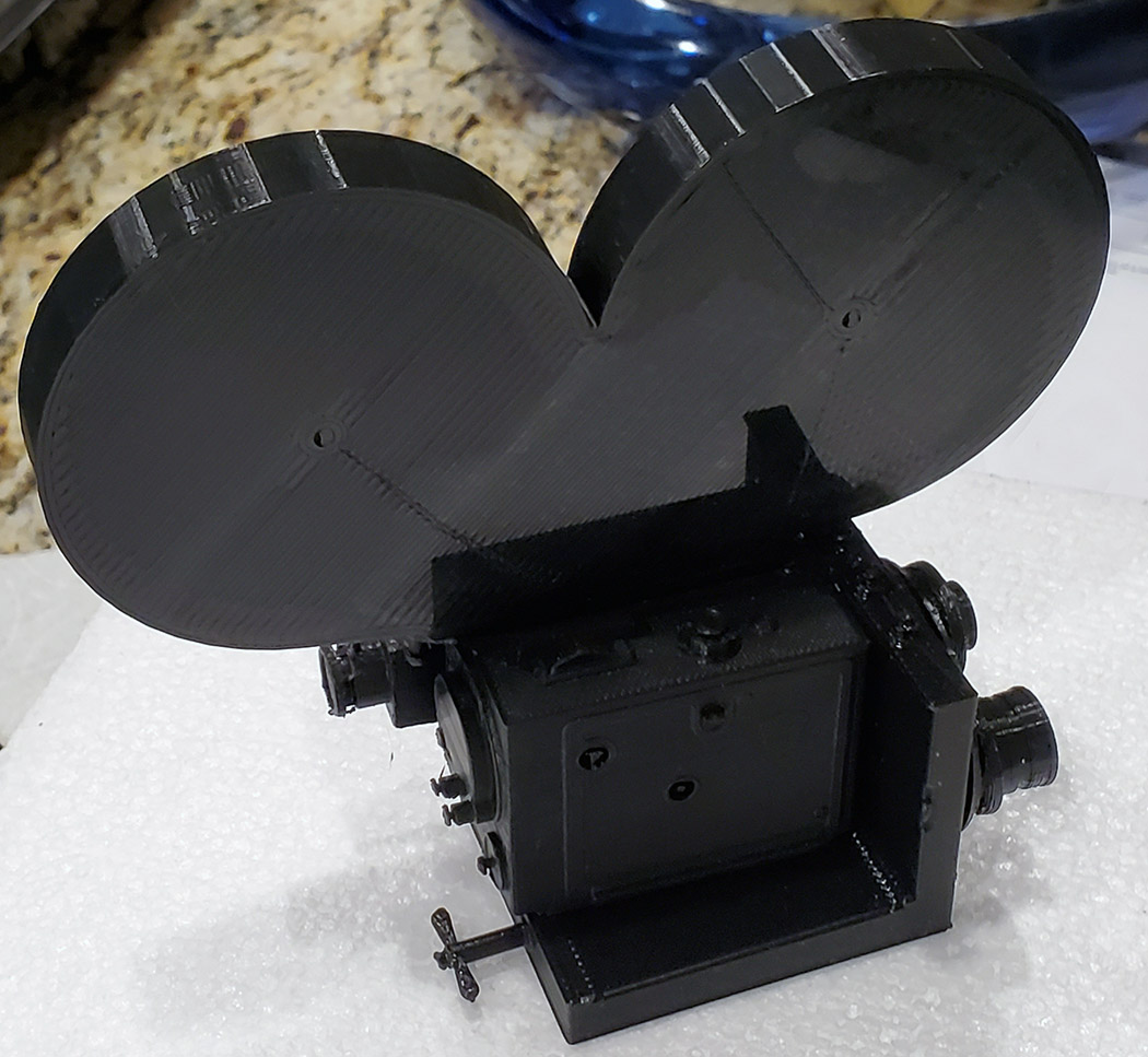

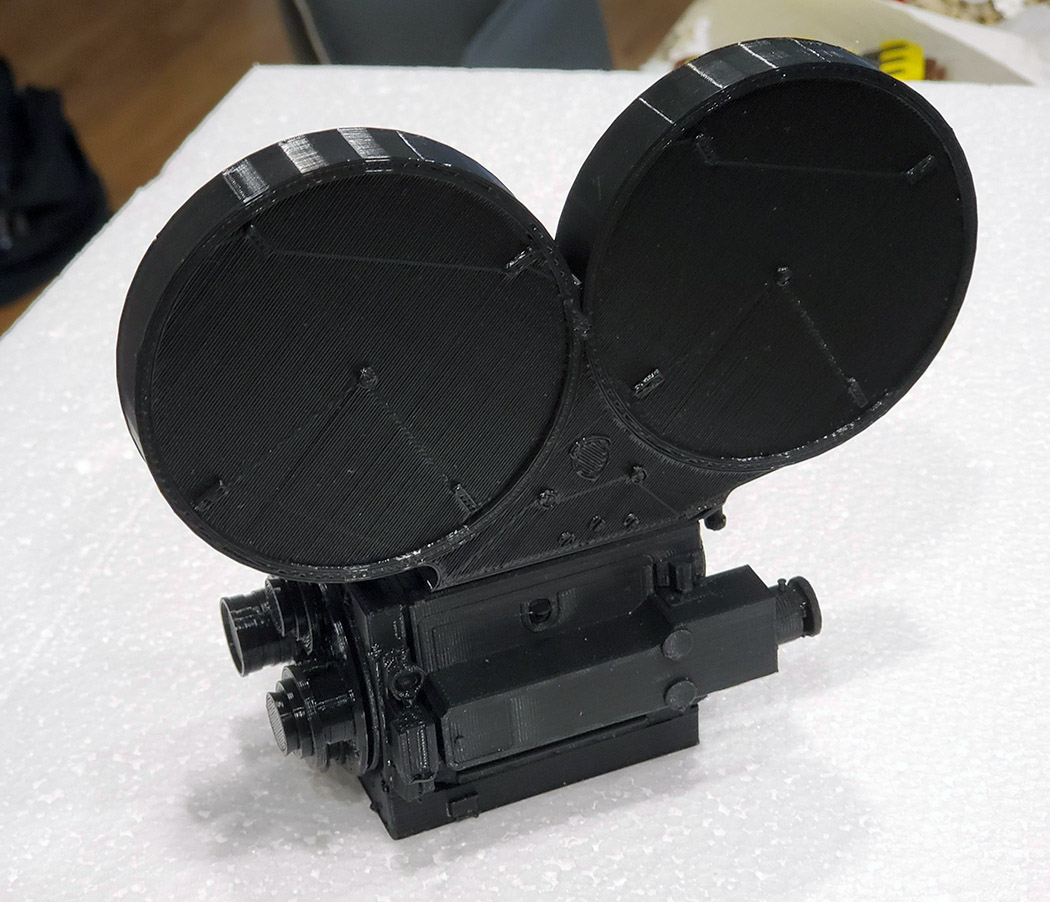

Post by admin » Thu Apr 18, 2019 7:41 am

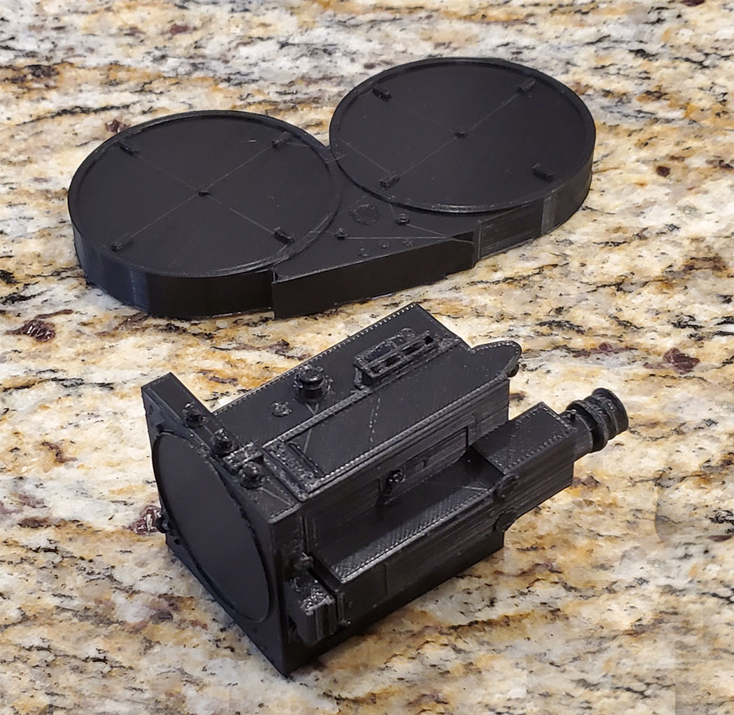

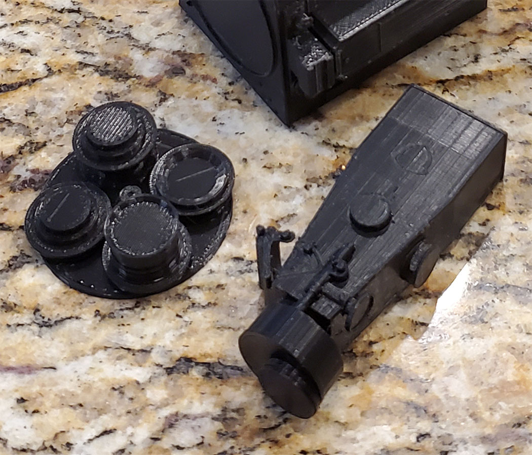

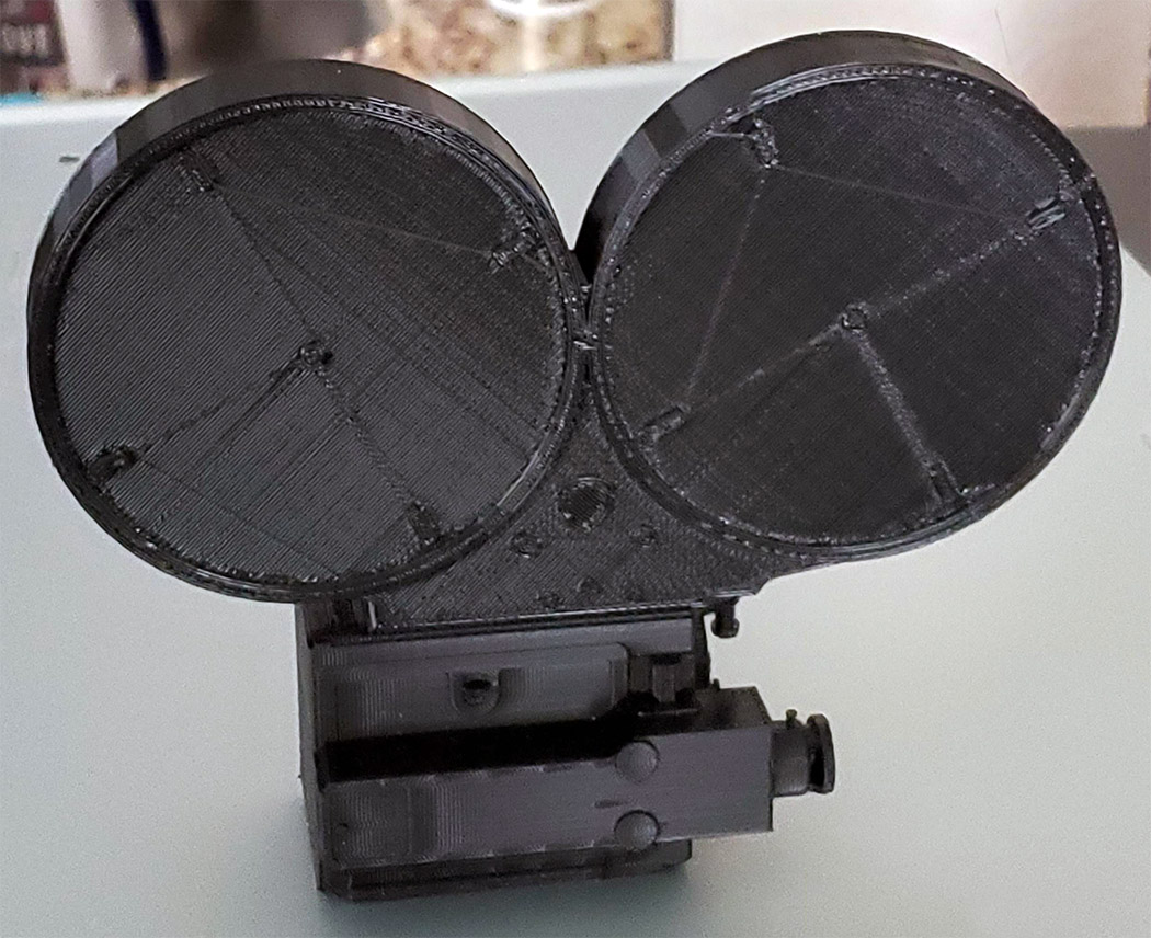

Mark sent me these photos showing the preliminary test fit of all the sub-parts. I am very impressed.
Click to Enlarge
Click to Enlarge
Click to Enlarge
