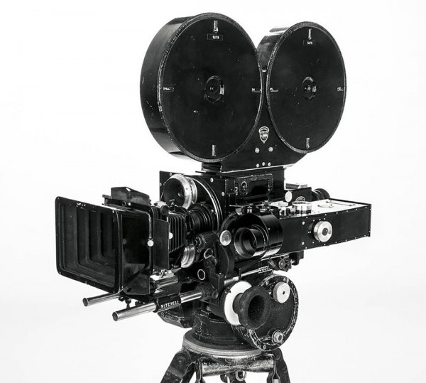

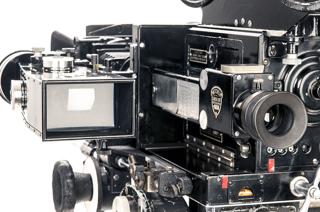

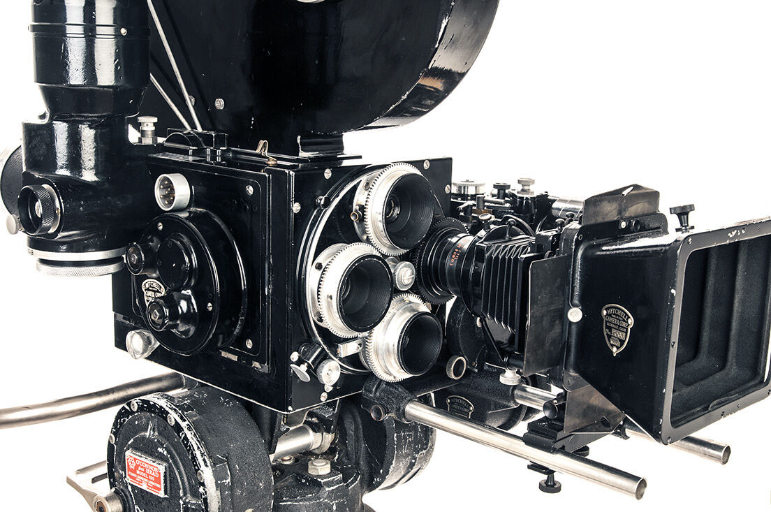

This camera was listed for sale by our friends at Seawood Photo and they did such a great job with the photos, I wanted to archive them here. If you are looking for a very nice Mitchell in the future, take a look at these beauty shots. This is the condition level you should aspire to for a great collectors piece.

I need help. I just purchased this camera and indeed Seawood Photo says it is a 1939 Mitchell NC, and yes it really looks just like the photos! But, it has the "acorn" plate on the camera body that simply has the numbers "397" with no model number below like the BNC serial number you show on this website. So, I wonder if this thing is even an NC at all, or some other Mitchell product. If I understand your NC serial number chart correctly, a serial number this high should have been manufactured around 1946 or 1947, so I'm confused as to why Seawood Photo was saying it was a 1939 Mitchell NC.
It has all of the accessories it should have including the side finder, matte box, follow focus mechanism, and four beautiful Baltar lenses. With the three included motors, this had to be someone's serious working camera!
Can anyone help me understand why the "acorn" serial number plate doesn't carry any model number on it like the BNC plate? Was that common on the NC models? Everything on this camera has Mitchell acorn plates all over it. It even came with a heavy-duty Mitchell set of legs. Can anyone help me to find out more about when this camera was manufactured or who might have used it? Thanks so much!

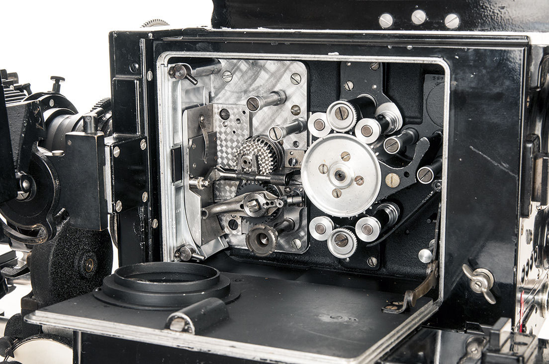

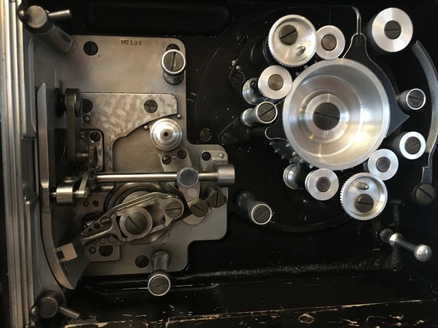

Third. The film drive mechanism is not an NC. The NC does not have a cam driven registration pin system (pictures to follow.)

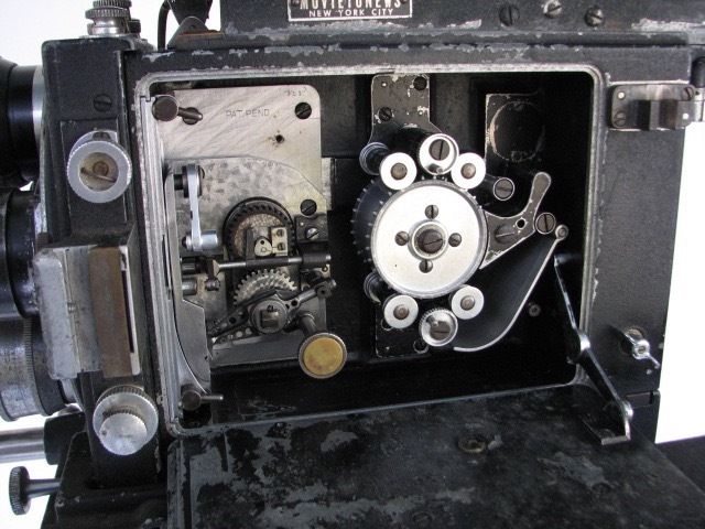

As part of our registration process, we do have detail shots of all the cameras registered. Here is the comparison of the different camera movements:
Here is the film movement for a standard (#151, 1928)
This is the film movement for an NC (#NC199, 1942)
Posts: 128

Rest assured your camera is complete but it is not an NC.
This can be seen from the evidence presented -especially the pictures of the differences between the film drives.
A complete camera is when the inside film movement plate, the outer badge and the stamp on the L base (remove the 12 o'clock lens to see the number) are all the same. Accessories like the motor, magazine, sidefinder and mattebox/compendium are never the same as the number of the camera. They each have a completely different numbering system.
Registration would be as Standard #397.
