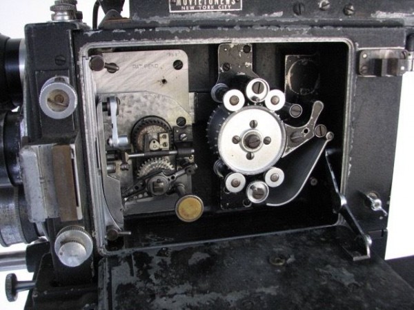

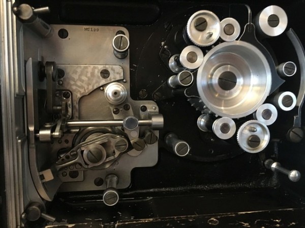

As part of our registration process, we do have detail shots of all the cameras registered. Here is the comparison of the different camera movements:
Here is the film movement for a standard (#151, 1928)
This is the film movement for an NC (#NC199, 1942)
