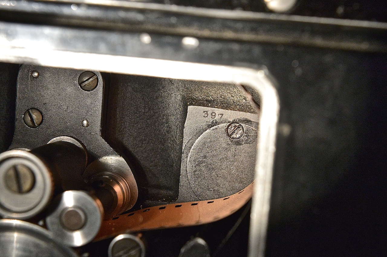

Just saw you posted the badge from the motor door on sunday. That is 4 for 4. Cannot get better than that!

Just shot a close-up of the "397" on the motor door. Photo attached.

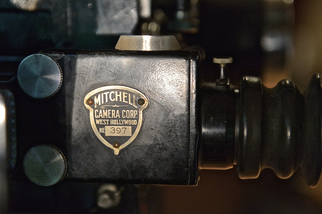

Here's one more photo of my Mitchell Standard 35mm camera. It is a close-up of the Mitchell "acorn" badge on the optical viewfinder used when the camera is racked over. It has the same number (397) as all the other numbered locations you told me about. It is strange that this number matches the other numbers because as you said, the accessories were all numbered differently. Maybe Mitchell didn't consider the optical viewfinder an accessory, but actually an integral part of the original camera. Otherwise, it must just be a coincidence. Either way, it is interesting to note that the badge on the outside (cranking) side of the camera says "Glendale Calif." and the badge on the optical viewfinder says "West Hollywood." See attached photo.
Chris

The camera door is not an accessory. It is a basic part of the camera rackover design and one of the top reasons the Mitchell camera became the premier motion picture camera over the Bell&Howell 2709.
