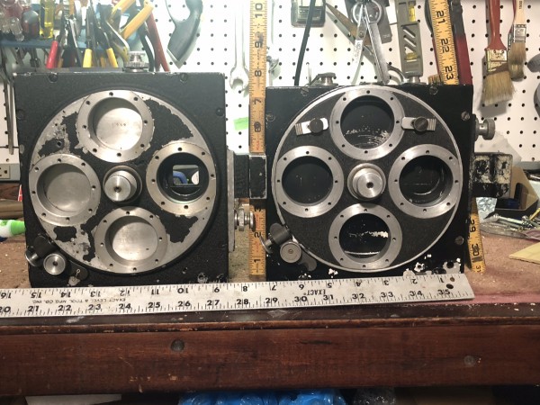

I am going to change that last answer about the silent camera.
Upon further review and looking at both of my cameras at about the same angle and comparing the L bases between the GC and NC, I have to place the camera as a GC and possibly high speed up to 120 FPS. The plaque on the camera door advises about oiling after high speed usage which is a feature overlooked.
The key comparison is the space above the turret on an NC that is not there on the GC. The 4way in-Camera matte is not a usual feature on a GC and was ordered specifically when purchased.
L base compare NC/GC
The NC base is to the right.
Re: I need your help
Posted: Sat Jan 18, 2020 2:43 pm
by mediaed
Ummm. Ever had one of those days?
NC is to the LEFT.
Going now ti beat my head against the wall.
