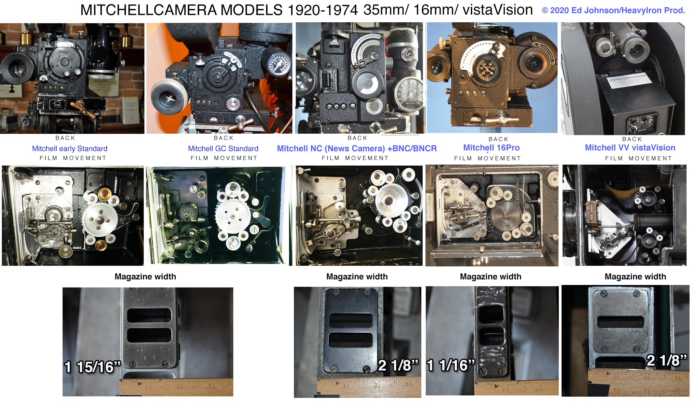

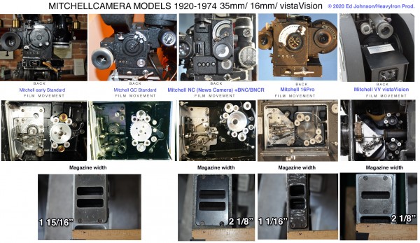

Sorry, It took some time to shoot and format pictorial description answer to your question. Did not include 70mm FC camera dimensions as a bit of overkill.I have a set of vistaVision magazines but not the camera. ED

Ah, I see now. My NC has been modified to take the narrower Standard/GC mags. You can see that the mag base has been modified. The visible silver metal shim rails are larger than what would be needed to neck down to the smaller width - I think the machinist made a mistake and took out too much metal on his first attempt (merde!) and shimmed it back to where he needed to be.

Thanks Ed for the mag chart.

Yes on the Mk1& 2's. Both were designed for the NC mags which were thicker for sound usage. NC mags come only in 1K size because of sound.
You could use standard mags and 400' on NC's and Sr35' s with an insert shim called a fork.

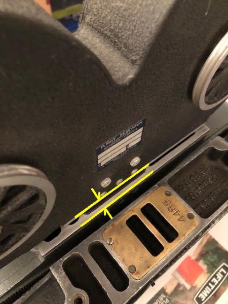

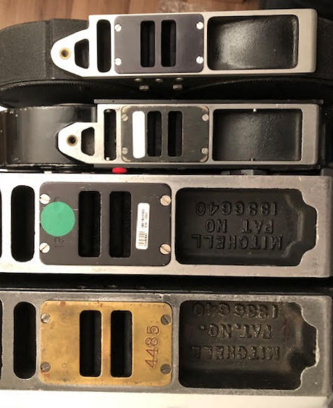

The relative difference in width is shown.
The 1000' with the brass throat is a West Hollywood build, the other 1000' is a Gendale build; the lower 400' is a very late Glendale build, and the upper 400' is a Flight Research unit (built in Richmond VA from the late 80's to mid 90's after they acquired the tooling). The 400' throats look smaller in the pic as the 400's are not on the same plane as the taller 1000 mags when the picture was taken.

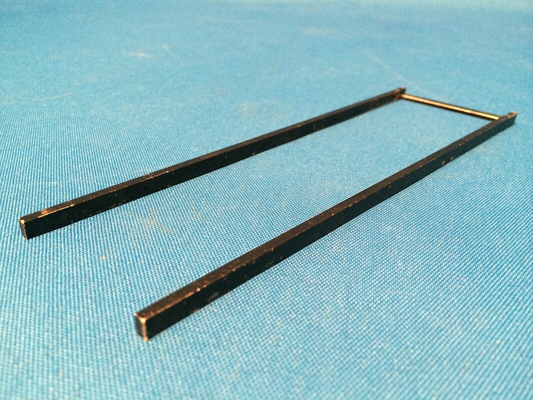

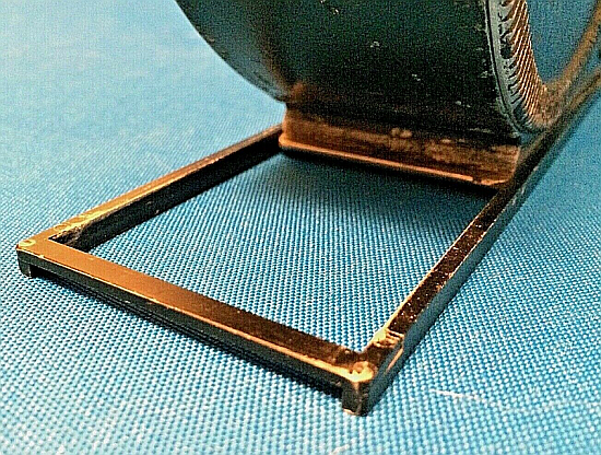

Ask, and sooner or later ebay shall provide. In this case, sooner...
Voila! - an example of a "fork" magazine adapter.
