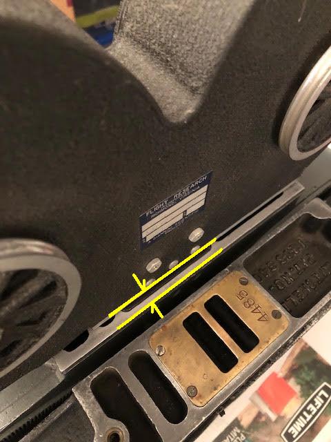

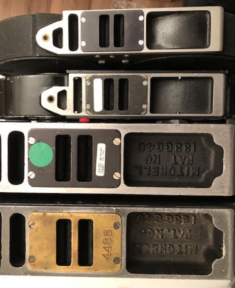

I have an NC, two Fries modified GC's and a MK II.  I have a couple of other (research) cameras that also use Mitchell mags. I've bought various mags along the way, typically all 400's.  I probably have a dozen mags plus a 400' bi-pack, all of different vintages.  They all fit my various cams, so nothing remarkable. Until now. A couple of 1000's popped up in the last year at a good price, so I bought a few jut for show. However, I discover there are two Mitchell mag-base mount widths. The 400's which fit my NC, GC and MK II and others are 1.940" wide. The 1000's I bought are all 2.200".
The one with the brass throat is a West Hollywood build, the other 1000 is a Gendale build;  the inner 400 is a very late Glendale build, and the outer is a Flight Research unit (so built in Richmond VA from the late 80's to mid 90's after they acquired the tooling).

I re-posted those first two pictures from my original post below in the method you suggest. I'm using Google pix and I think it has strict permissions which is the issue. It works fine in Chrome when I'm logged in, but I see the pictures don't load in FIrefox. Always best to check in a second browser. However, uploading as you suggest resolves this problem and is much, much easier. Thanks !
The relative difference in width is shown.
The 1000' with the brass throat is a West Hollywood build, the other 1000' is a Gendale build; the lower 400' is a very late Glendale build, and the upper 400' is a Flight Research unit (built in Richmond VA from the late 80's to mid 90's after they acquired the tooling). The 400' throats look smaller in the pic as the 400's are not on the same plane as the taller 1000 mags when the picture was taken.
So in summary,
Standards and GCs use the narrower 1 15/16" throat base plate mag
NCs, BNCs and BNCRs all use the wider 2 1/8" throat base plate mag
Mitchell MK I / MK II's follow the route of BNC/BNCRs as they were designed as a sound camera from scratch and use the wider 2 1/8" mag
You can adapt down from the wider to the narrower mag using shims.

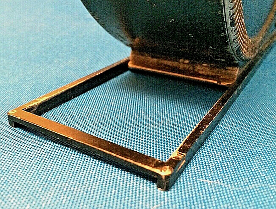

Did Mitchell offer this shim arrangement ("fork") as an official part?

Yes. I do believe Ken Stone has one. I have seen one recently on eBay maybe from Wayne Goldwyn....

Voila! - an example of a "fork" magazine adapter.
