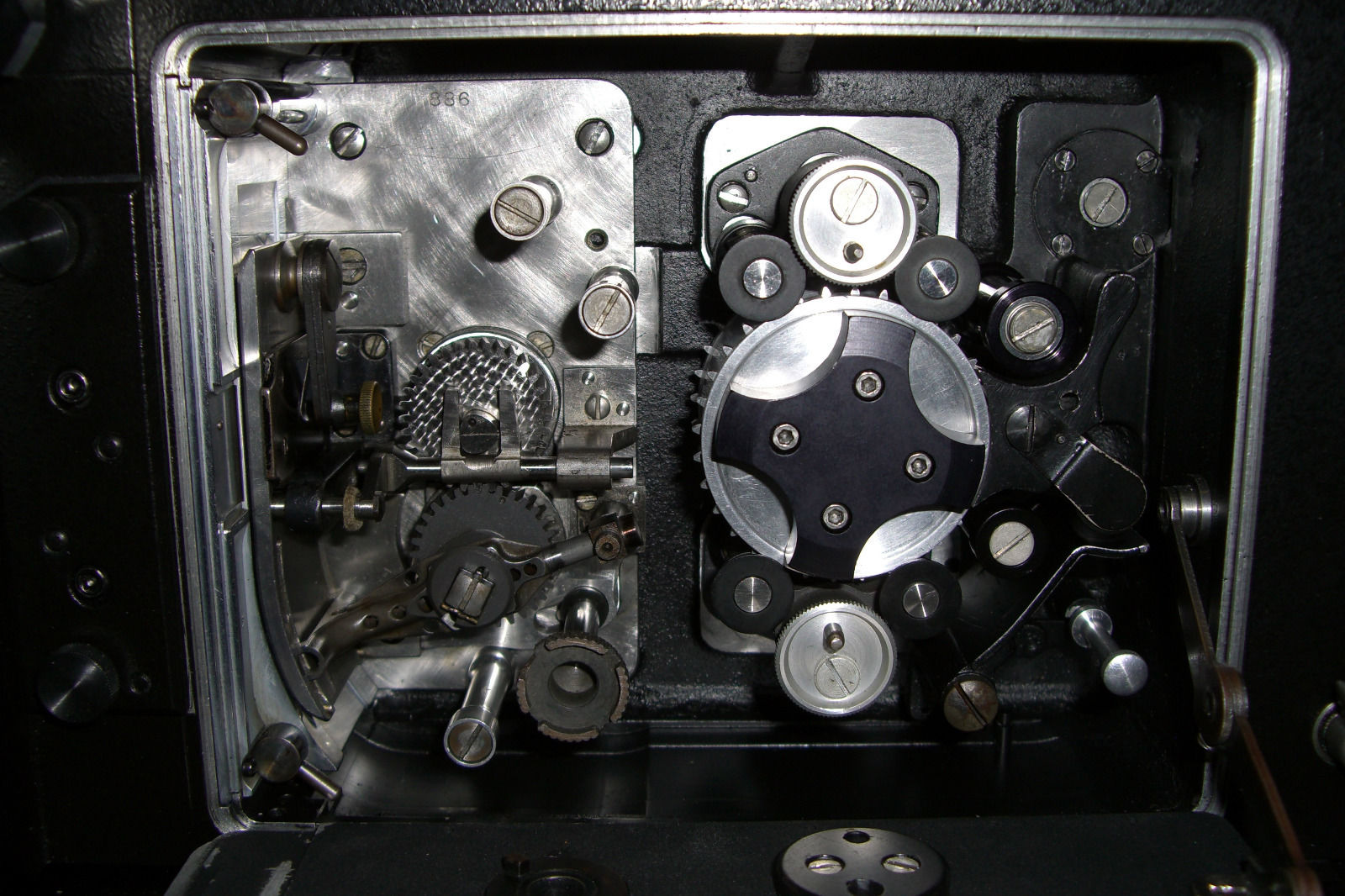

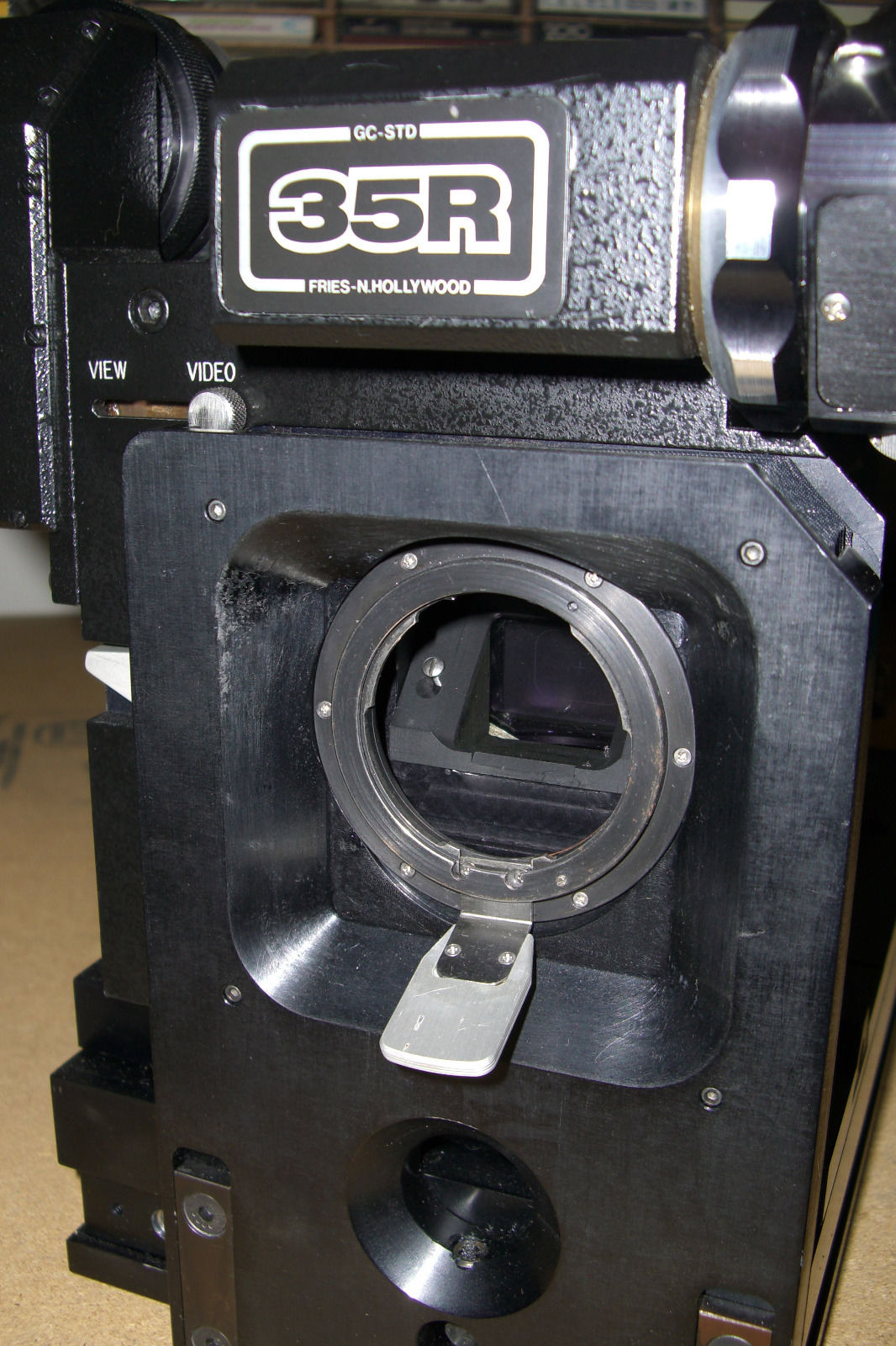

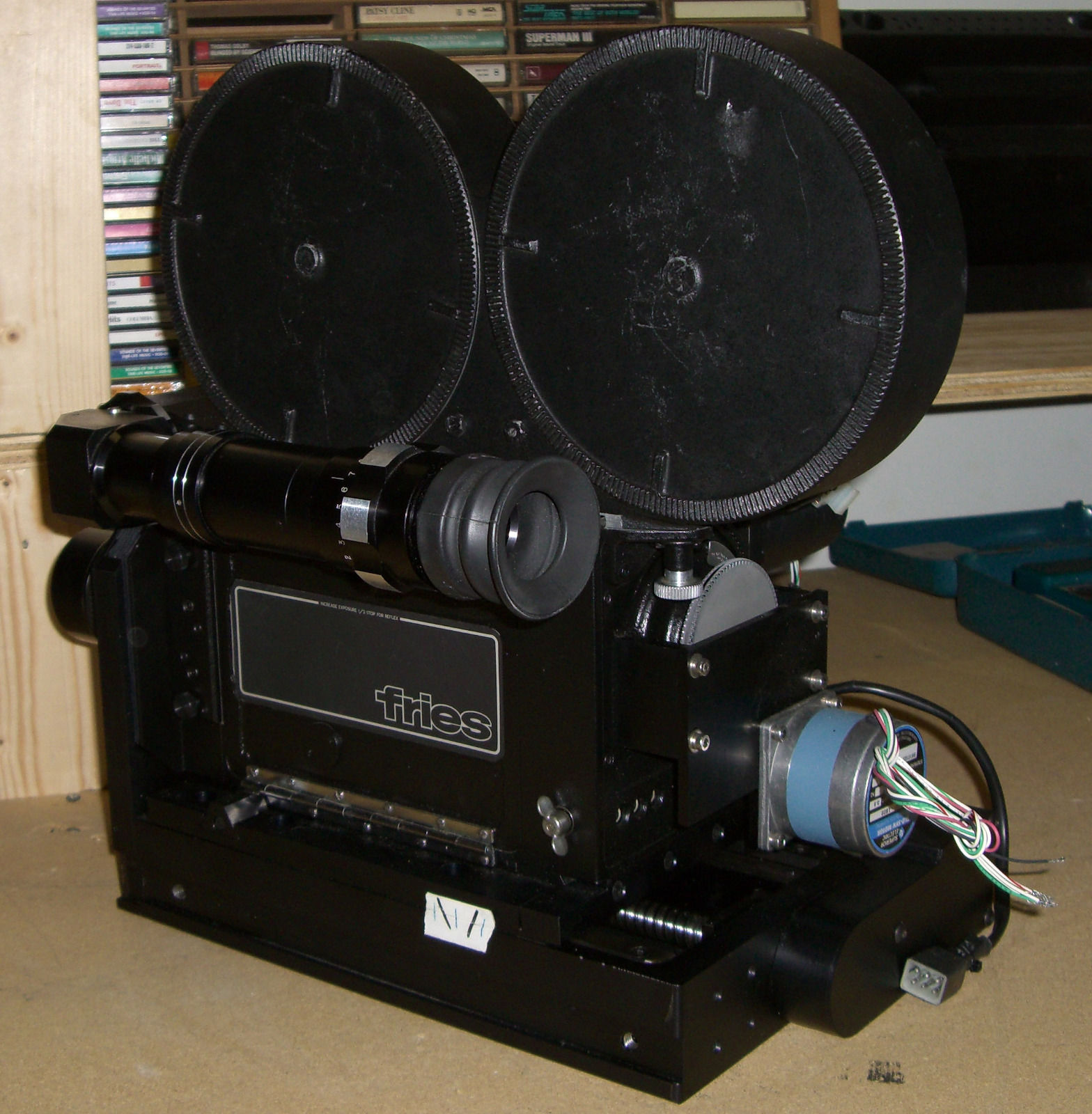

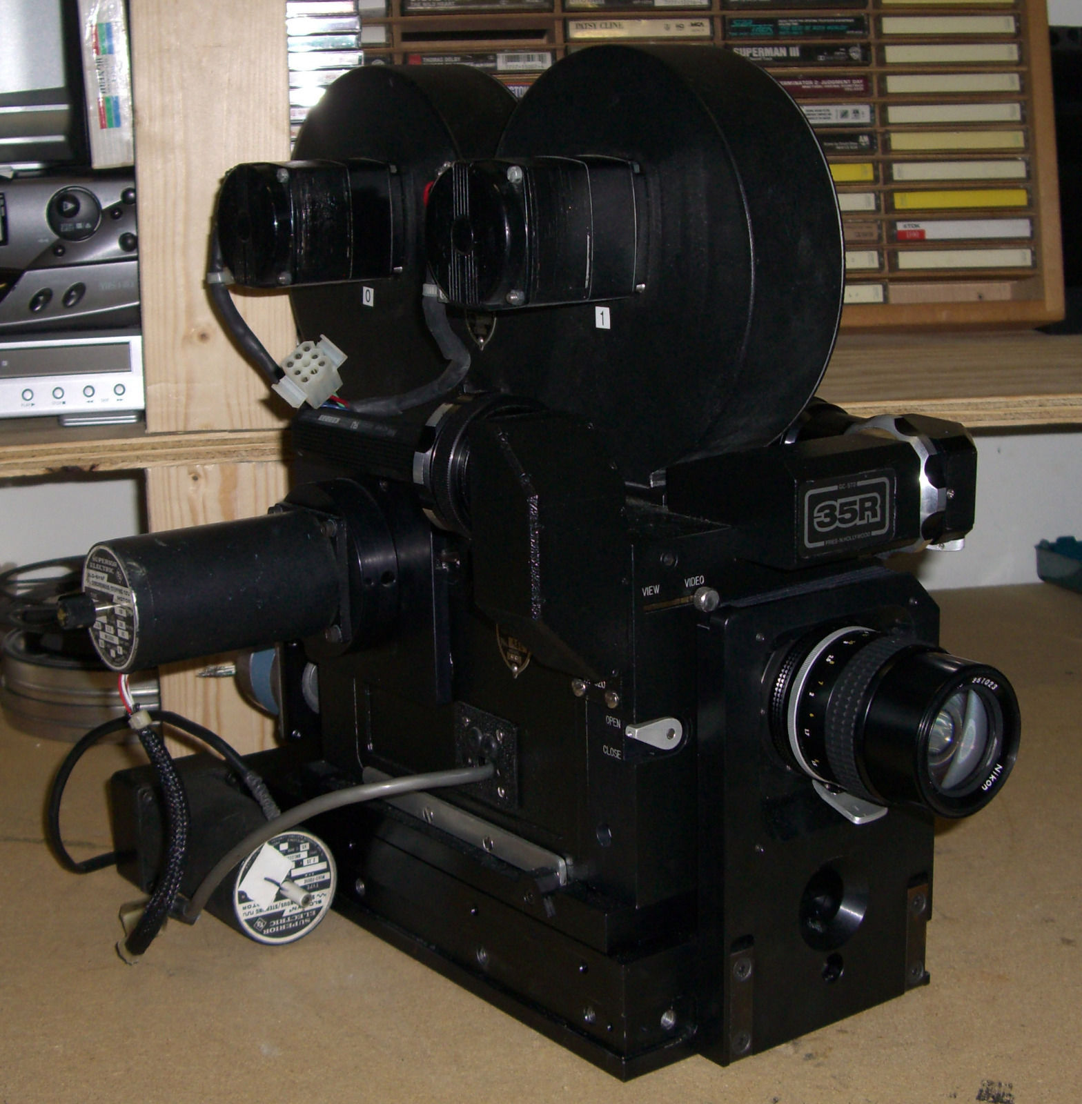

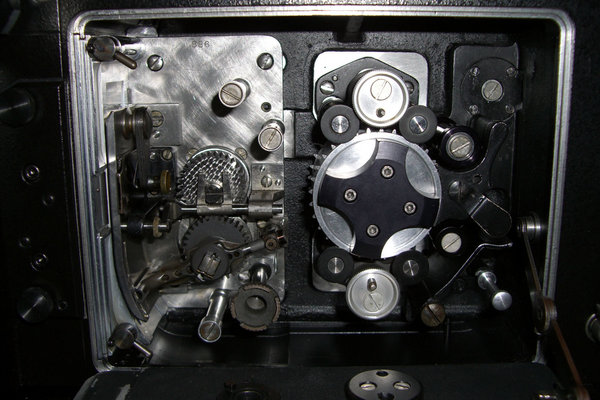

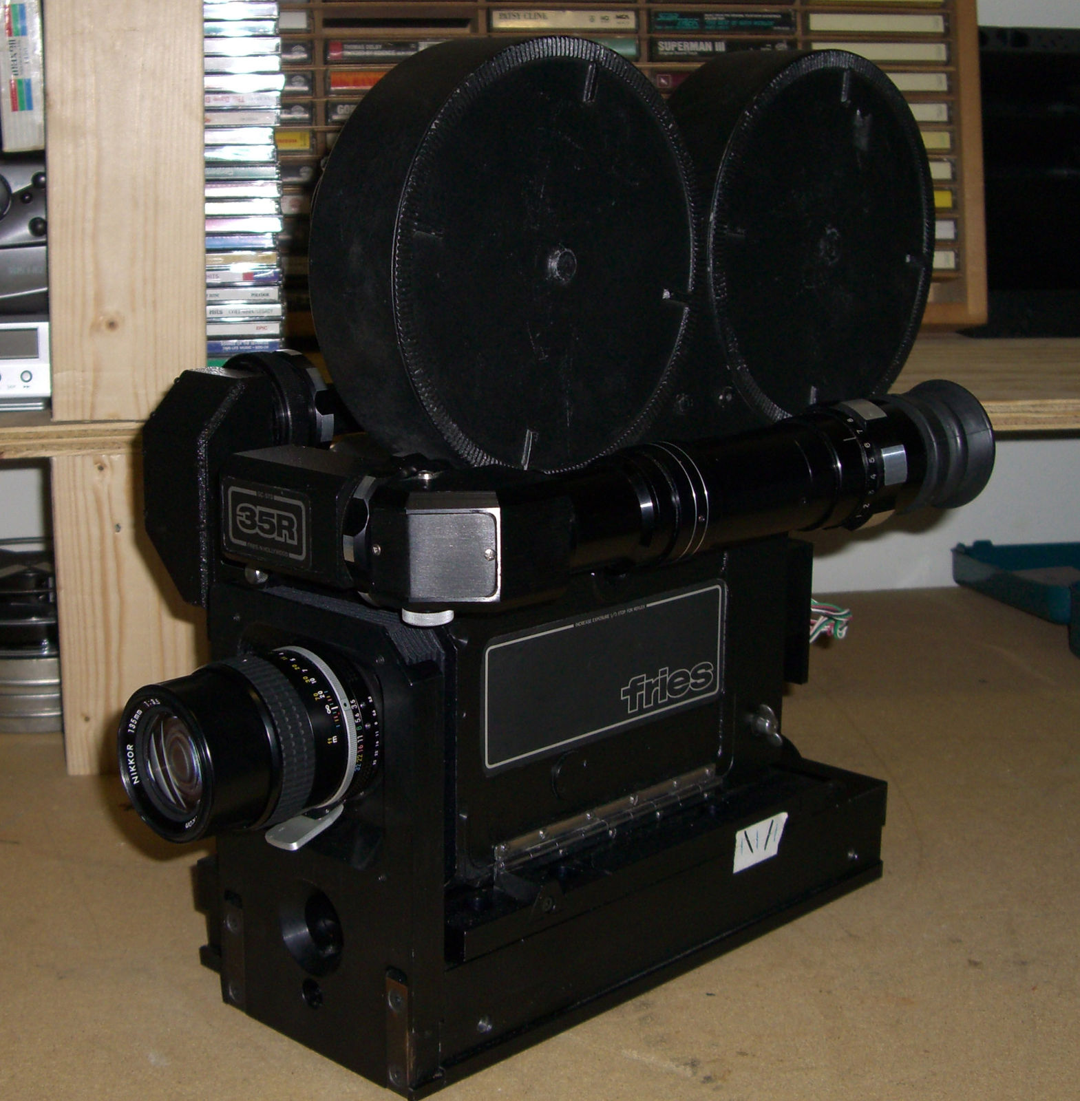

There is a Fries-Mitchell rig on EBAY right now. I have uploaded pictures. The seller wants $9,500 but is is all setup for motion control:
This item is a 35mm Fries AF35R Motion Control Stop Motion Animation and High Speed Visual Effects Camera. This complete unit and all accessories are in excellent working condition. The complete package includes the AF35R camera with video tap assist and case. A 400 foot Fries Mitchell conversion magazine with A.C. torque motors. A regular 400 foot Mitchell magazine. And a Fries AF35R operation manual. The item is pictured with a Nikkor lens, but does not come with it or any other lenses. The Fries AF35R (Auto-Focus 35R), a reflex conversion to the Mitchell Standard/High Speed camera, is the same as the standard 35R with the addition of an auto-focus base. The auto-focus base is a sliding plate with a bellows attachment that holds the lens in a fixed position, while the camera body is moved to achieve focus. With this approach to focusing, you maintain a constant distance from the lens nodal point to the mounting surface of the AF35R camera. This is commonly called a fixed nodal point system which greatly simplifies the programming required for the computer controlled or motion controlled camera tracking systems. The modular design of the 35R conversion allows great flexibility in customizing to special requirements.

The auto-focus base is an aluminum casting 13.25 inches long by 4.75 in width. There are four 3/18-16 threaded inserts in the bottom surface. The camera mounts to the upper sliding focusing plate, which is attached to the base by two crossed roller "Microslides", and positioned by a .200 Inch travel per revolution lead screw. The lead screw is driven by a stepper motor (or motor of your choice). The focusing plate allows for a full 4.75 inches of travel.

Through the lens reflexing is accomplished using a glass plate type beamsplitter that diverts 1/3 stop of light from the film to the viewing system. The beamsplitter itself is of the latest design, utilizing a very thin glass with the highest efficiency anti-reflection coating.

The 35R reflex viewfinder uses all new coated optics for a crisp, bright image at 5X magnification. The eyepiece is adjustable for individual focus and is positioned for comfortable right or left eye viewing. The viewing image is manually correctable through 360º rotation of the viewfinder.

The Nikon lensmount is on standard Academy centerline or on full-frame silent centerline for those shooting background plates, etc.
