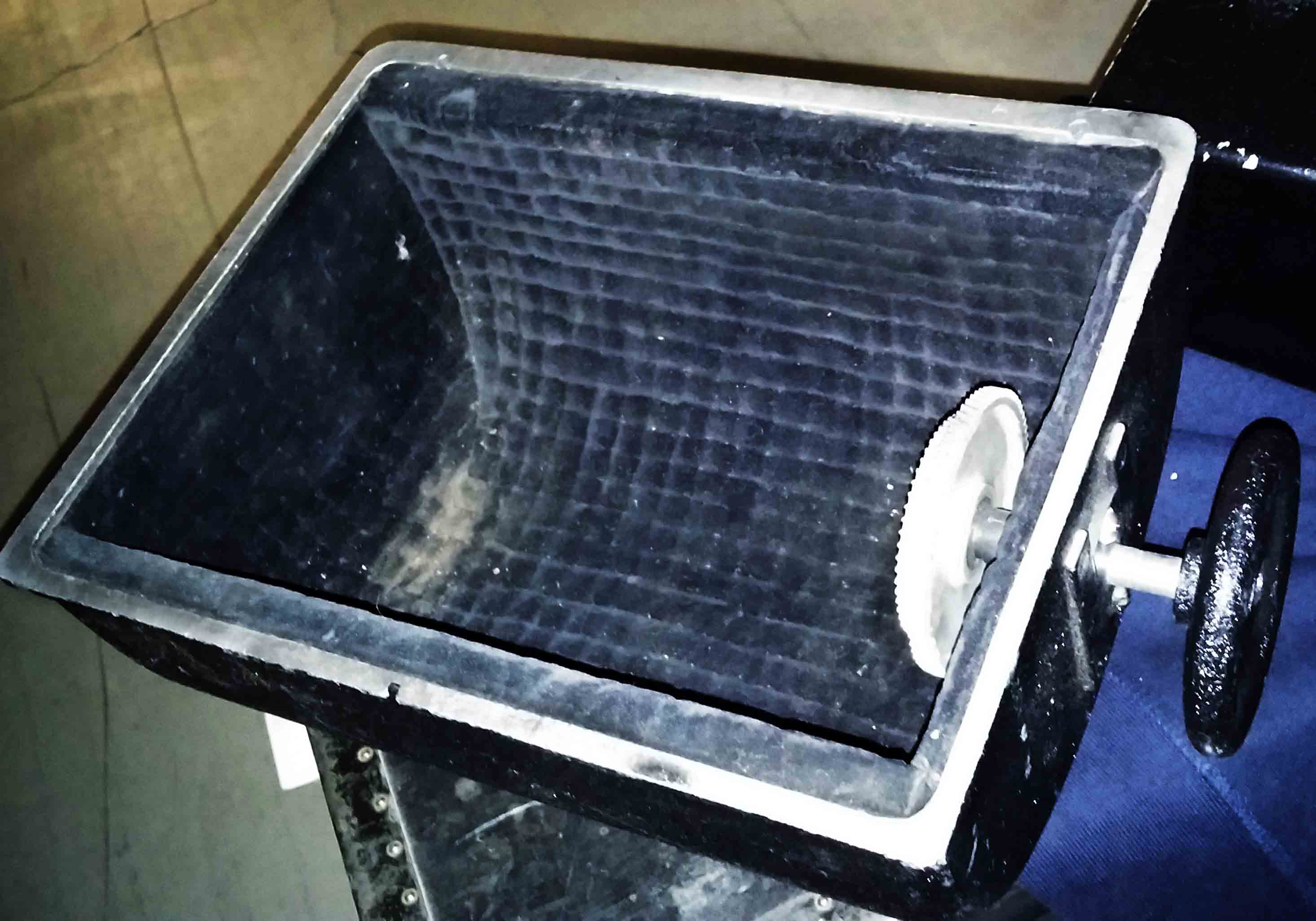

Quilted Sound Dampening inside Classic BNC Motor Cover

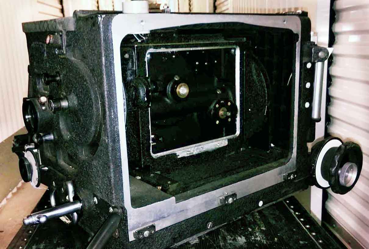

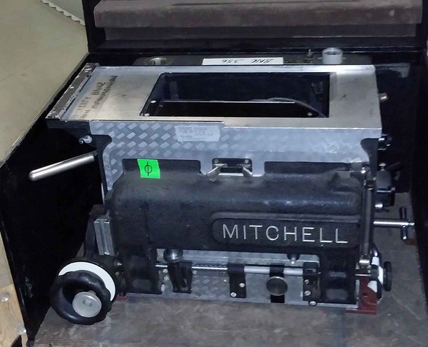

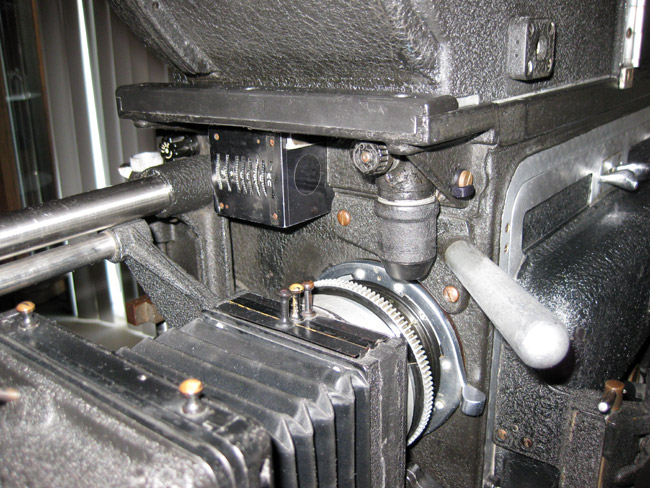

Another View of Mitchell BNC blimped L Plate and camera Box .
BNC L Plate and Camera Box Construction

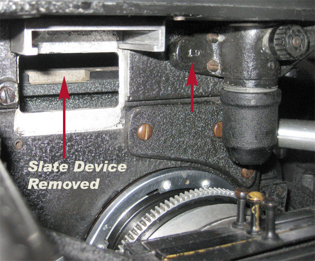

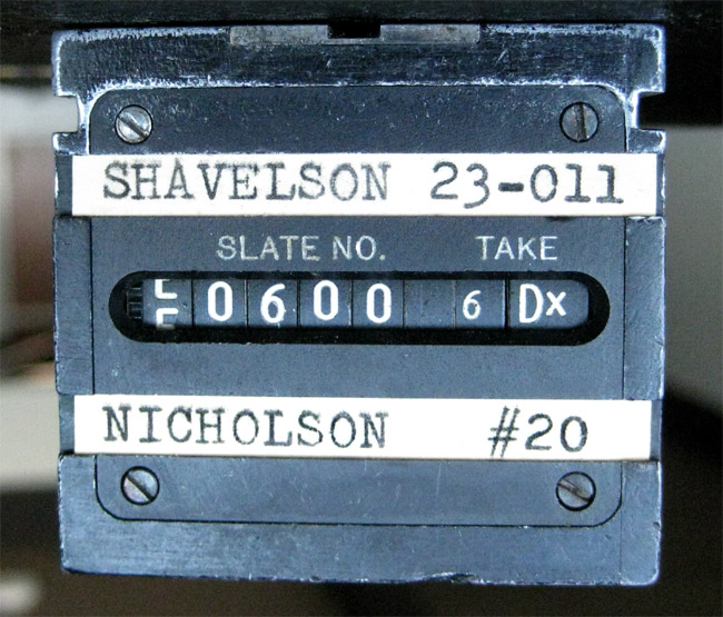

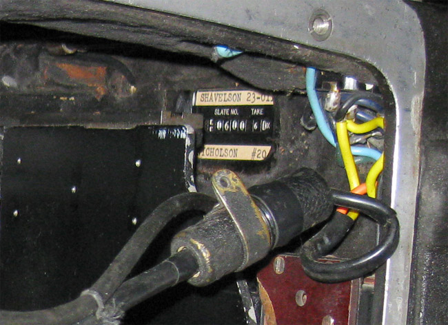

Hello Bruce. I very much enjoyed your excellent article/observations regarding the BNC construction. I find after market automatic slating/blooper devices particularly interesting. This web site had some photos of one such device which I have included here. Am I to understand that your BNC 356 had no such device whatsoever? If so, what a special unmodified BNC!
With greatest respect,
Max

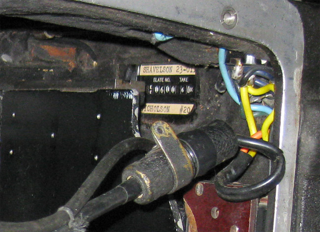

Mitchell BNC 356 had no slate mechanism at all.
BNC 356 rolled off the assembly line at the Mitchell factory in Dec 1967, according to Mitchell foreman
Chuck Mallory.
And in 1990 every BNC I tore down from an old Panavision auction had some kind of slate mechanism.

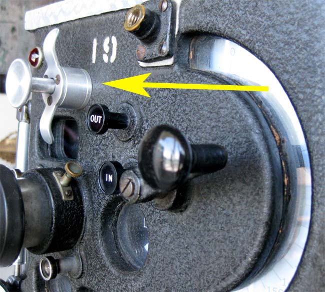

Hello Bruce and thanks for the great info on Mitchell BNCs. I am not in the industry but have interest and am a collector. I own a BNC which was owned by Paramount and converted to reflex by way of Pelical (for those that don't know what it is: a mirror reflex system that passes some of the light to the viewfinder and the rest to the film).
Regarding the film slate issue; did you ever work for Paramount? Apparently they installed a film punch in the camera to Mark scenes by physically punching the film. After exposure they would, in the darkroom, feel for those punches and develop only the takes they wanted. I guess it was a bit nerve racking if they missed the punch mark, or forgot to make the punch mark!

Hi Mark. I read with great interest regarding your Paramount BNC. Tell me sir, I assume it has the Film Punch mechanism installed? If so, does it look like the picture attached? I'm sure Bruce will be commenting on this as well.
Max
