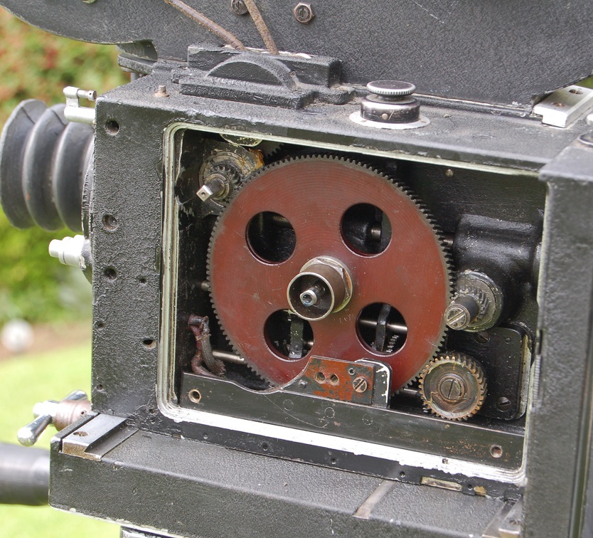

It seems now that when my Mitchell was 'adapted' for single frame animation, the fly wheel was removed, hence the now stiffish movement when turning the crank.

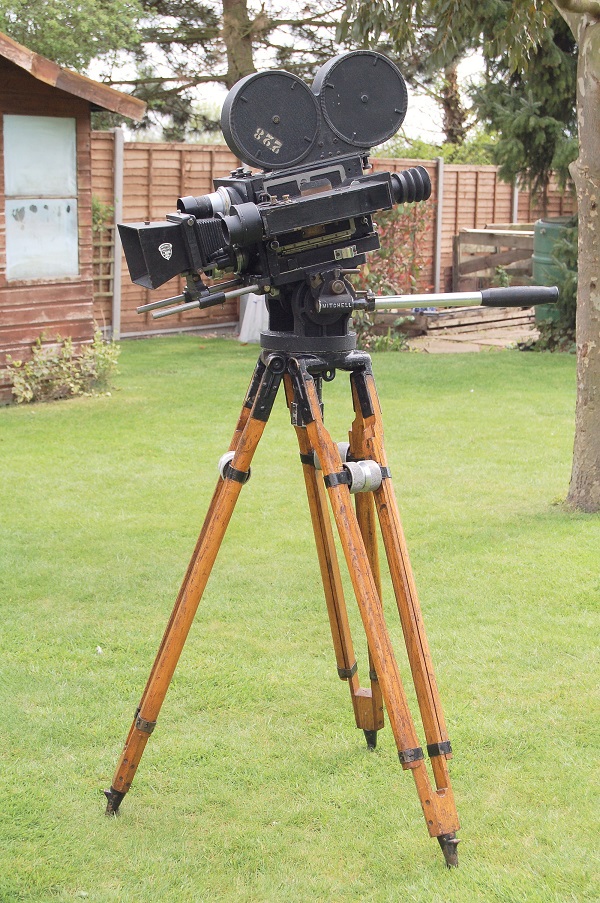

Re: Stiff Movement on Mitchell Standard (advice)
Very nice shot of your Mitchell sir. Thank you for sharing!

Pleasure. So this is what's missing internally from my Mitchell. A flywheel (from another Mitchell image) which may make the cranking a bit easier?
Odd to remove the flywheel. Yes could affect the movement. As far as I can see removal accomplished very little other than limiting the camera in future. Coming from RKO, this may well have been a camera that could have been in the RKO Fearless blimp I feature in my member's article. ED.

Thanks for all this information. Very useful. As can be seen from my Mitchell inside, the big driving cog looks to be a replacement?
Large gear does look different but we have to remember that these were hand built. It has been suggested in many resources that individual cameras were entirely put together and machined by one person.

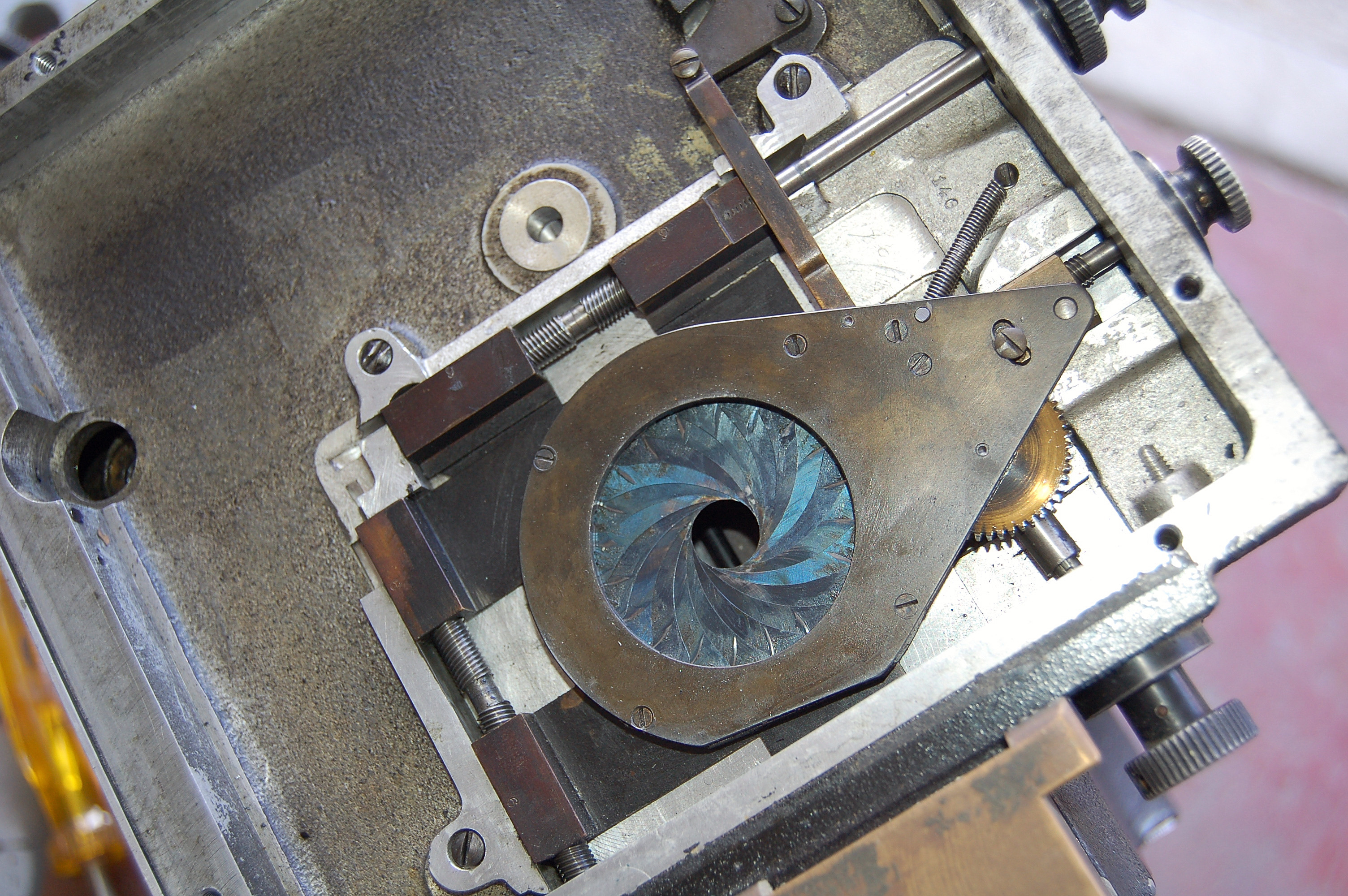

I note that you have the dissolve timing adjustment as well as the controls for the floating iris and 4-way mattes. (Do they work?) But most of all I do want to say since your first post, you did not waste any time finding all the parts you needed to make this camera whole. Congrats. Took me few months on my last project.
Thanks Ed. Unfortunately my Mitchell is not complete, missing the entire front panel and turret. I do now have a Mitchell side finder s/n 427 and a 'Peanut' motor to complete the 'look'. The dissolve mechanism is still there but disconnected. The iris and matte system is fully operational. The number 146 appears throughout the mechanism, on other parts. The 200ft magazine has '228' painted on if that is of any significance? I might also add that I'm UK based. I'm not certain how many of these Mitchells are currently in England. Not many I suspect.
