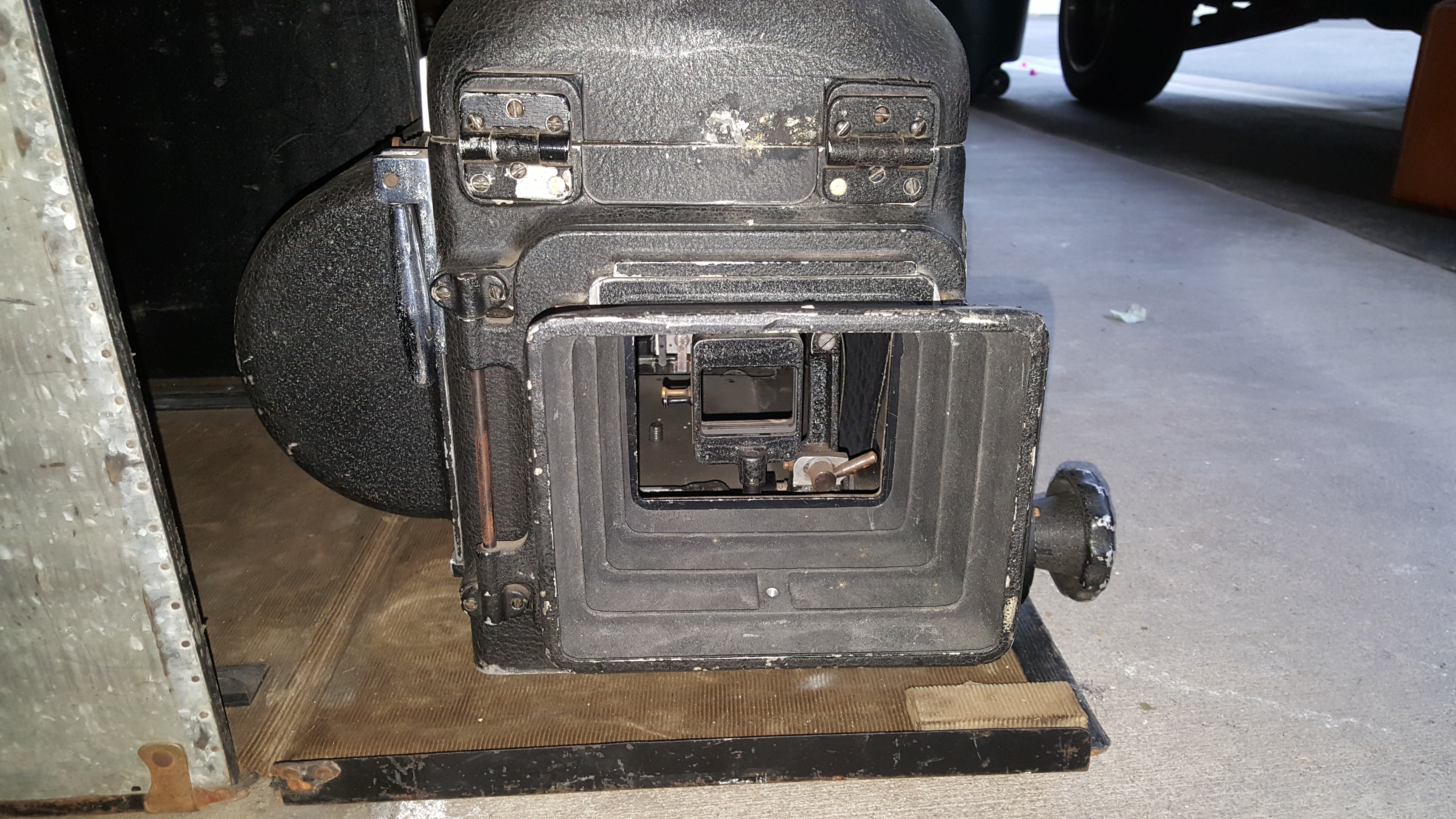

Post by Guest » Thu Nov 23, 2017 2:30 am
Year?
Does anyone know what year and model?
Information
Posts: 126
Post by marop » Thu Nov 23, 2017 1:14 pm
Hello,
This is a “Blimp” for a 16mm Mitchel movie camera. In case you don’t know what a blimp is, it’s a sound reducing camera housing for use during sound recording so the sound of the camera running is not recorded. I’m not aware of any particular models of these and there probably was only one, with maybe some changes over the years. This is likely from the 60’s-70’s, but I am not sure when they started making them nor when they stopped.
I hope this helps,
Post by mediaed » Thu Nov 23, 2017 5:27 pm
Mark is on the money but I can add some more information. This is a 400' sound blimp for a Mitchell 16Pro camera. The cameras were introduced in 1947. Probably the blimp would have been very shortly thereafter if not part of the initial packages. These cameras were phased out by the early 70's in favor of a more modern design loosely based on Arriflex cameras that were starting to take over the professional market.
There was another version of the blimp later (probably mid-50's) that allowed for use of the 1200' magazines which understandably was quite bulbous. This one pictured has the rare square filter holder which is a definate plus. Because these cameras used double perf 16 film with dual registration pins and could film up to 120fps, they were mostly research cameras. The blimps were not as numerous as they were only required for productions doing sound work.
If you want to see how this works with a 16Pro camera, click.on the "member's articles" tab on the front page and select the first article which has my stop motion videos of the major Blimped cameras is the 1950's to 1960's' My 16Pro with blimp is the 5th video.
The camera is #333 from 1961 the blimp is #134 from the mid 1950's so whatever your serial number is, that will give you some idea of approximate age.
Feel free to contact if you have any more questions. ED.
