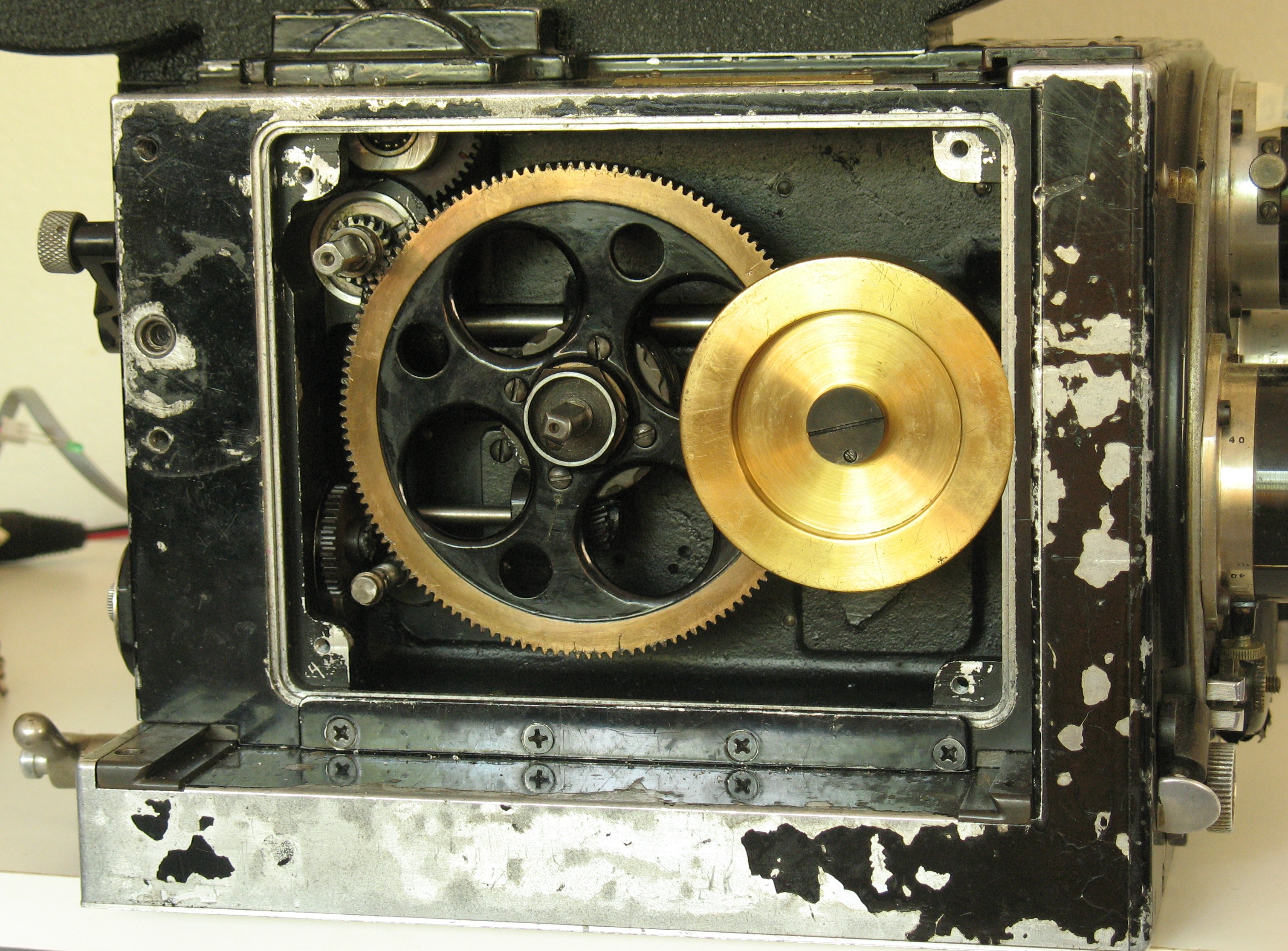

Thanks Ed. I'm in comms with Ken Stone. Good guy. I used light machine oil. Still looking at various options. The movement is very very much looser when I crank using the top left electric motor port, it's just the big central cog that's tough going. Feels as if there's a fly wheel missing?

Pleasure. So this is what's missing internally from my Mitchell. A flywheel (from another Mitchell image) which may make the cranking a bit easier?
Re: Stiff Movement on Mitchell Standard (advice)
Post by mediaed » Sun May 22, 2016 3:25 pm
Odd to remove the flywheel. Yes could affect the movement. As far as I can see removal accomplished very little other than limiting the camera in future. Coming from RKO, this may well have been a camera that could have been in the RKO Fearless blimp I feature in my member's article. ED.

Thanks for all this information. Very useful. As can be seen from my Mitchell inside, the big driving cog looks to be a replacement?
Post by mediaed » Sat May 28, 2016 2:10 pm
Large gear does look different but we have to remember that these were hand built. It has been suggested in many resources that individual cameras were entirely put together and machined by one person.

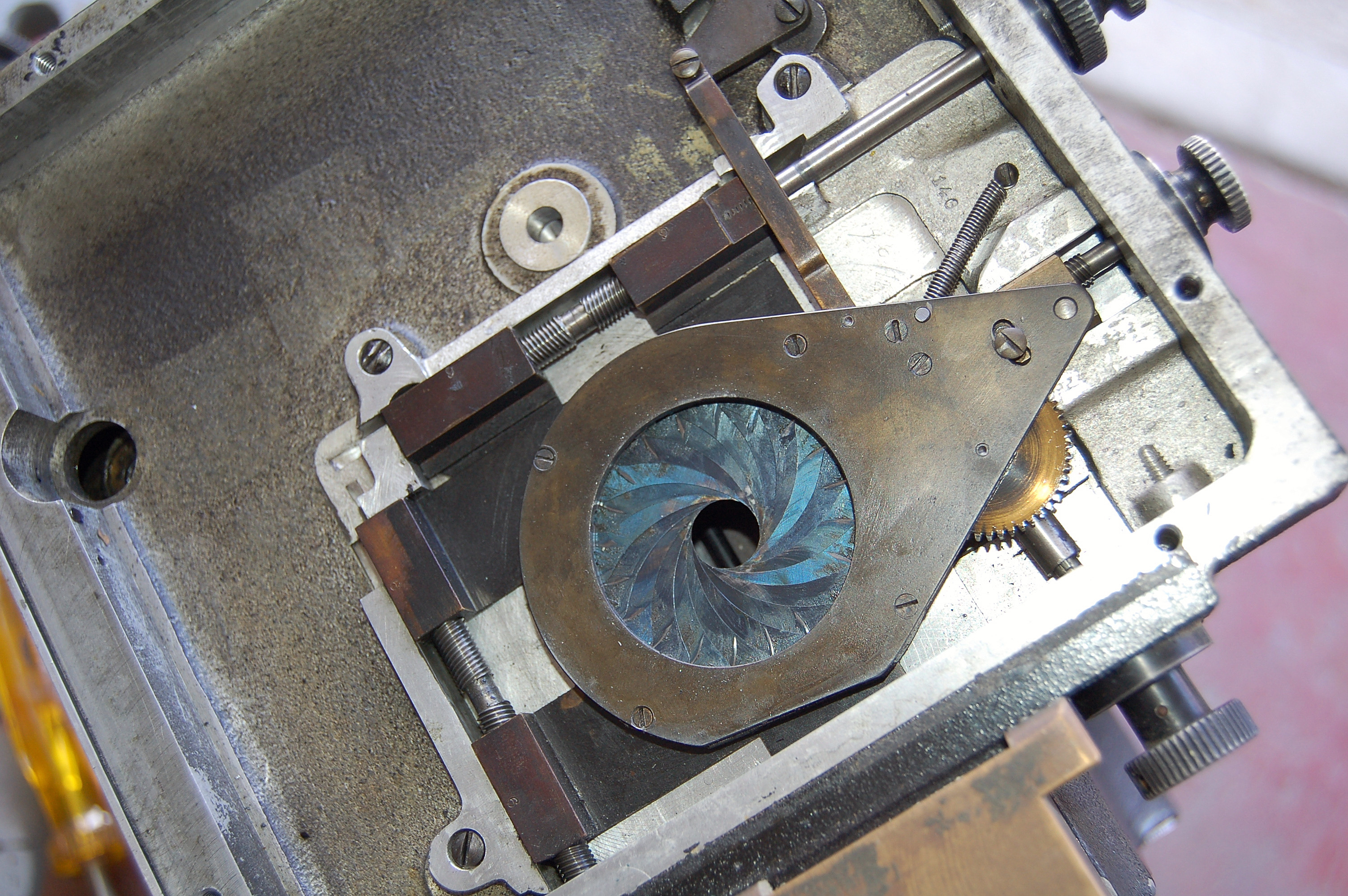

I note that you have the dissolve timing adjustment as well as the controls for the floating iris and 4-way mattes. (Do they work?) But most of all I do want to say since your first post, you did not waste any time finding all the parts you needed to make this camera whole. Congrats. Took me few months on my last project.

Thanks Ed. Unfortunately my Mitchell is not complete, missing the entire front panel and turret. I do now have a Mitchell side finder s/n 427 and a 'Peanut' motor to complete the 'look'. The dissolve mechanism is still there but disconnected. The iris and matte system is fully operational. The number 146 appears throughout the mechanism, on other parts.
