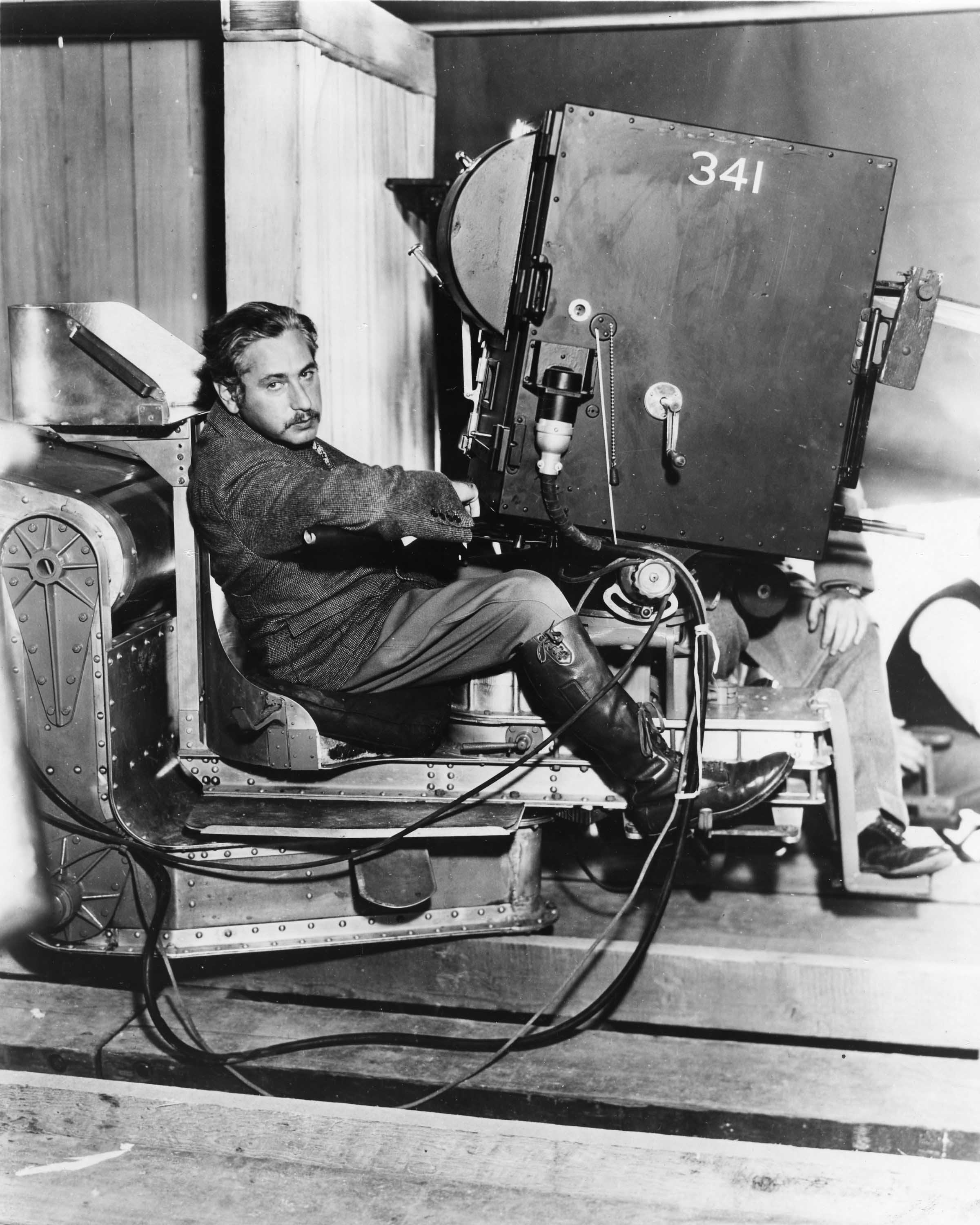

Okay, here is one of the first I found for my Standard. Searching images on the internet using various words and phrases, like "Paramount Director" I came up with probably one of the best photos I could ask for. Again, you can not see my camera but the blimp is marked with it's serial number. This is Josef Von Sternberg (the man who "found" Marlene Dietrich) on the set of The Scarlet Empress, staring Marlene Dietrich.
Josef Von Sternberg with a Mitchell Standard

Best thread here ever! These "investigation tips" are invaluable. I'm learning here, and with the phd and all - that says something! But the photos are extra special too, the last one with the BFC and riding boots is over the top classic!
Keep on filmin'
